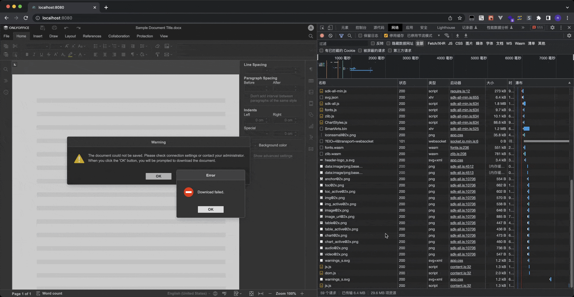

This is part of the front-end react code, the url of this file is correct, and it can be downloaded from the browser. But when I open the page in the browser, it will report an error that the download failed
This file can of course also be downloaded from the browser
