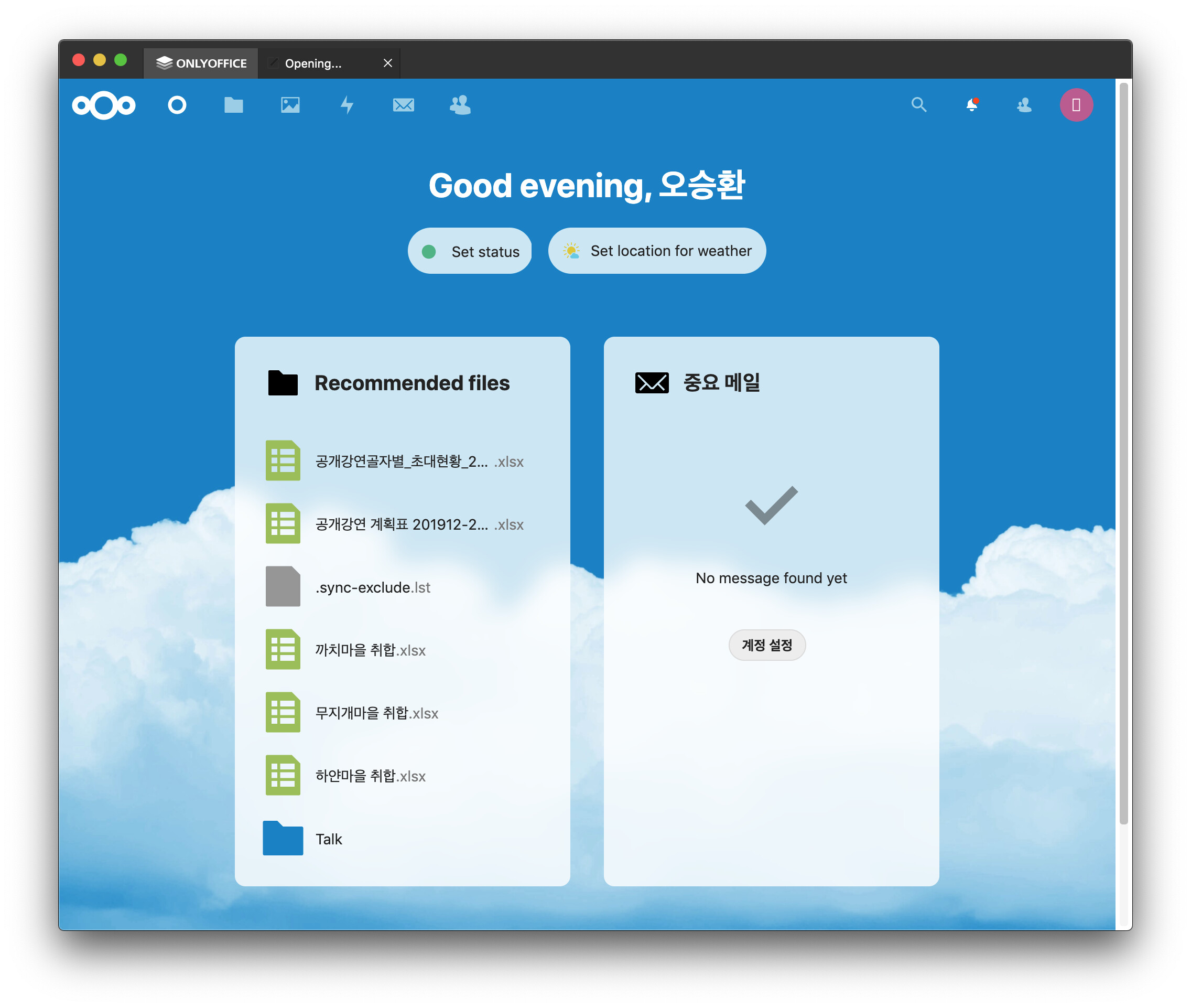

For reference, if I select a file in the recommended file on the initial screen as shown in the figure below, it opens normally in the desktop app.
However, as in the screenshot above, this phenomenon occurs when opening a folder and selecting a file.
