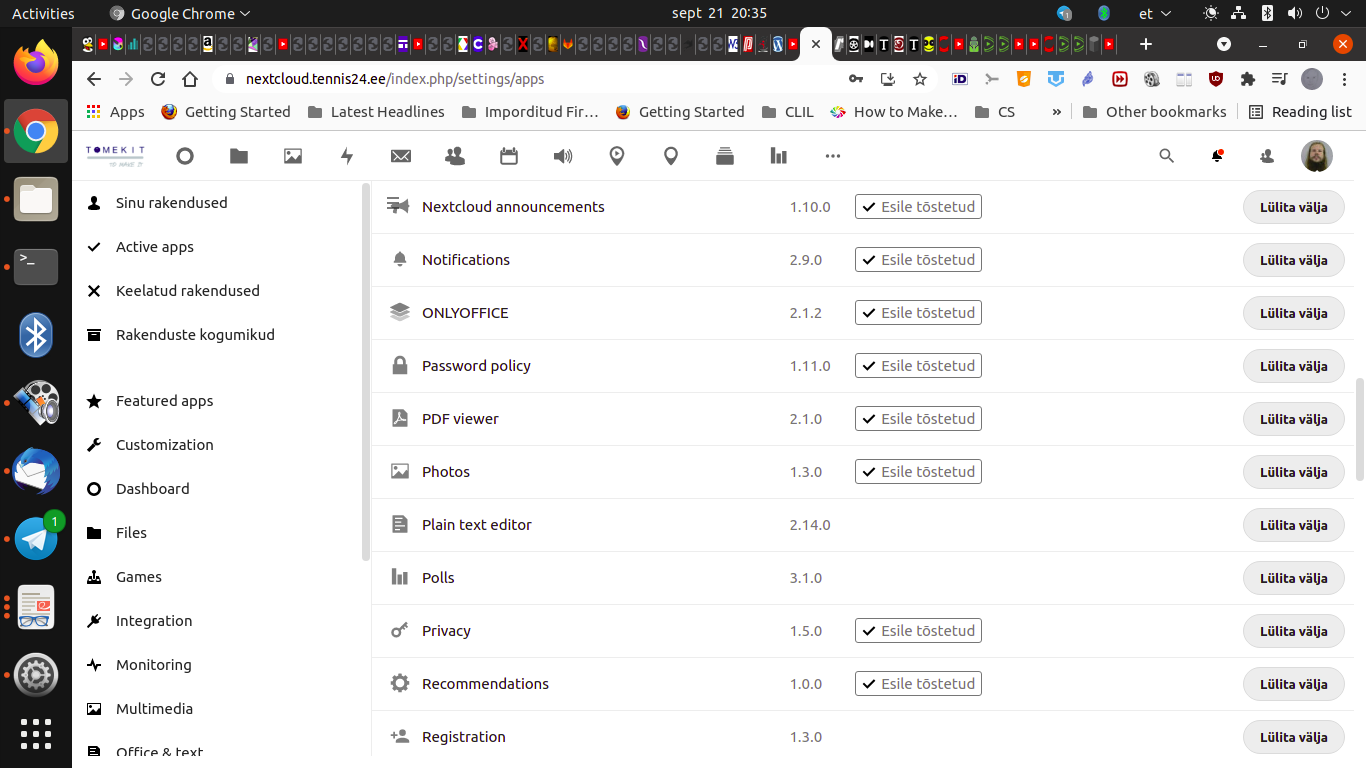

Go to Nextcloud => Apps => find ONLYOFFICE in the list and there you will see the version.
I did exactly as you instructed and found the info about the version: 2.1.2
Could you please attach a screenshot of the app list where ONLYOFFICE version can be seen?
If the connector version you are using is indeed 2.1.2, it is extremely old and incompatible with Nextcloud 21:
https://apps.nextcloud.com/apps/onlyoffice/releases?platform=21#21
Please install the current connector version 7.1.2 and after that try to reproduce the issue.
