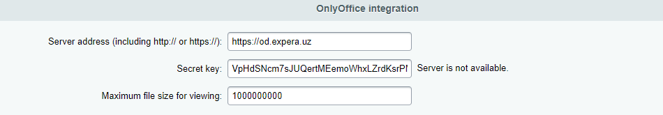

in the api settings of Bitrix CMS, the server address and its key are registered. the system reports that the server is not available

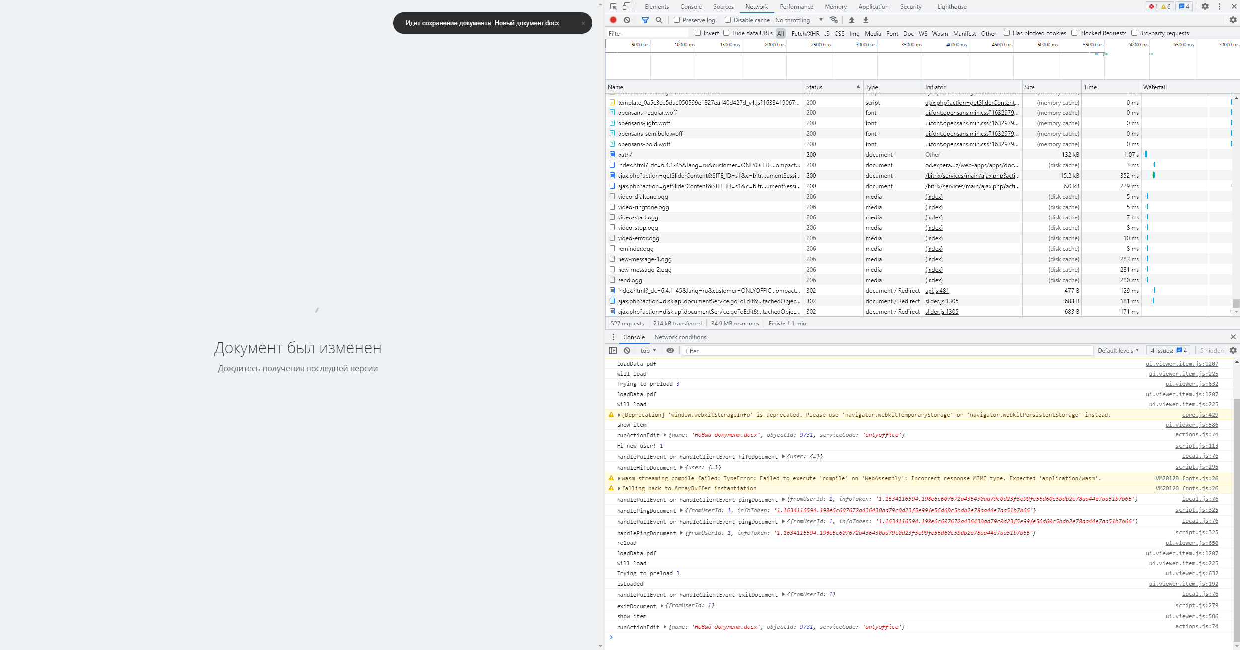

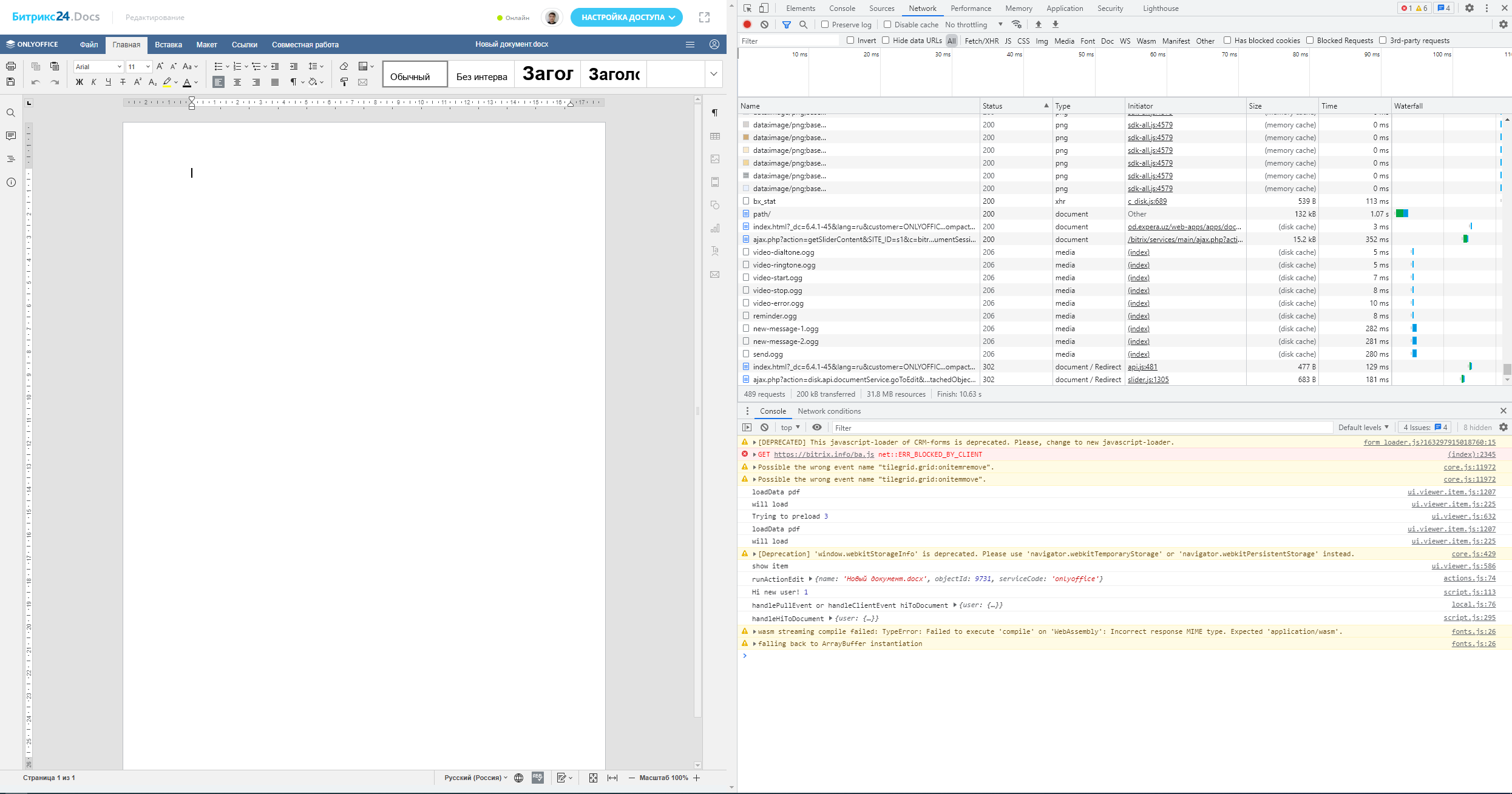

I can view documents, go into editing, but the changed data will not be loaded into Bitrix CMS from OnlyOffice Docs
if i change the link from https to http it says that the server is available, but I cannot connect to the dox server for editing
no errors are displayed in the interface

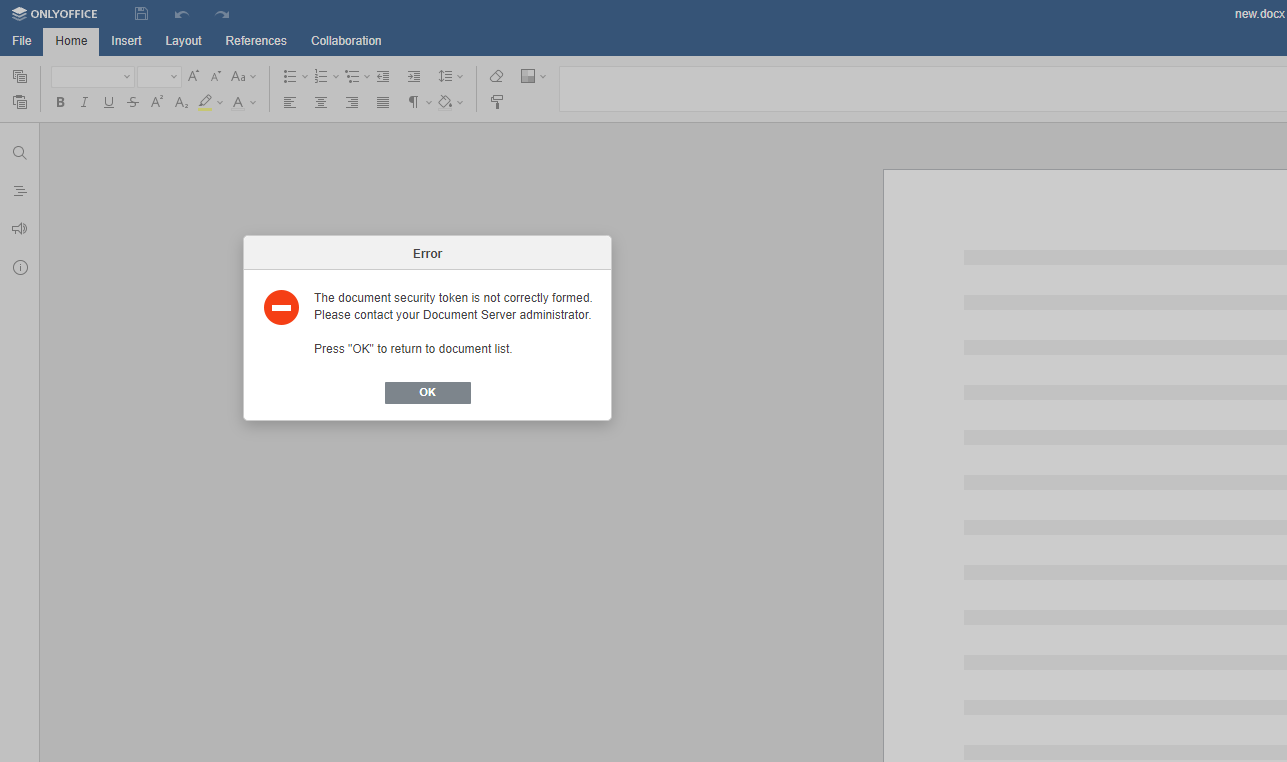

installed version 6.3.0.11, connected the OnlyOffice via http, click on the file that I want to open, the OnlyOffice form is loaded and gives an error that the file is not loaded
First of all, please install the latest Document Server version 6.4.1.
Please make a screenshot of the error you see in the editor interface. Also open the document editor => then open developer tools in the browser (F12 in Chrome/Firefox) => refresh the editor page (F5) and check if there are any errors in Console and Network tab. If yes, make screenshots.

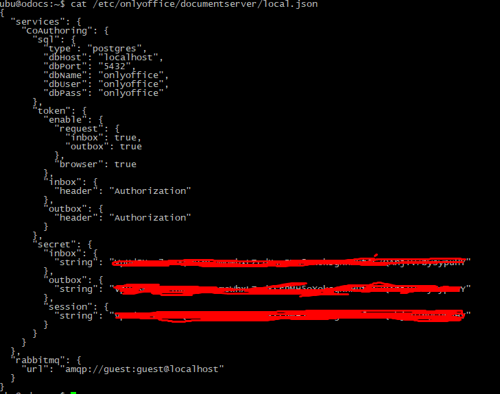

local.json
both servers are behind nginx-proxy
For the example to work with JWT, you also need to enable it in its config
/etc/onlyoffice/documentserver-example/default.json
As for your screenshots from Bitrix, this really looks like an integration issue rather than the Document Server issue. Please contact Bitrix with the description of the problem.
My mistake, I forgot that the root certificate ran out on centos 7, blocked it and everything worked
