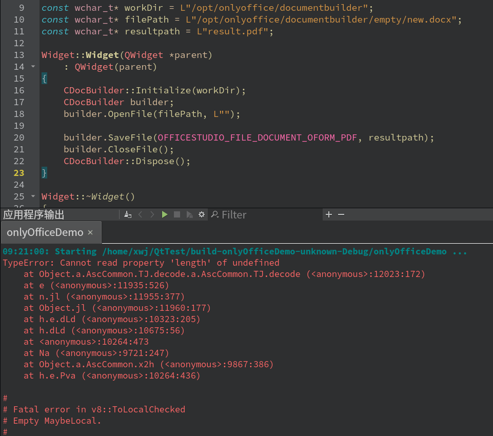

When converting DOCX to PDF using the C++ API, we encounter:
TypeError: Cannot read property 'length' of undefined
    at Object.a.AscCommon.NU.decode.a.AscCommon.NU.decode (<anonymous>:11662:172)
    at e (<anonymous>:11577:526)
    at n.au (<anonymous>:11597:402)
    at Object.au (<anonymous>:11602:10)
    at e.vGd (<anonymous>:10401:495)
    at e.vGd (<anonymous>:10704:213)
    at <anonymous>:10345:382
    at da (<anonymous>:9653:313)
    at Object.a.AscCommon.aQh (<anonymous>:9835:127)
    at e.yO (<anonymous>:10345:345)
# Fatal error in v8::ToLocalChecked
# Empty MaybeLocal.
Full stack trace shows failure in V8 engine during decoding.
Code Implementation:
// main.cpp
#include "common.h"
#include "docbuilder.h"
using namespace NSDoctRenderer;
const wchar_t* workDir = L"/opt/onlyoffice/documentbuilder";
const wchar_t* filePath = L"/opt/onlyoffice/documentbuilder/empty/new.docx";
const wchar_t* resultPath = L"result.pdf";
int main()
    // initialize DocBuilder
    CDocBuilder::Initialize(workDir);
    CDocBuilder builder;
    builder.OpenFile(filePath, L"");
    // save as PDF and close
    builder.SaveFile(OFFICESTUDIO_FILE_DOCUMENT_OFORM_PDF, resultPath);
    builder.CloseFile();
    CDocBuilder::Dispose();
    return 0;
