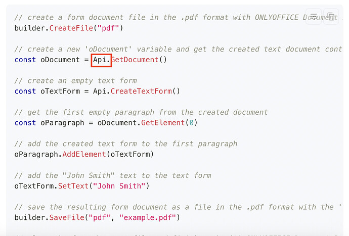

Hello @Anton2,
For now there is no yet PDF API, the methods mentioned above are not suitable for PDF Editor, here you can see all the methods available within Form API - Form API | ONLYOFFICE

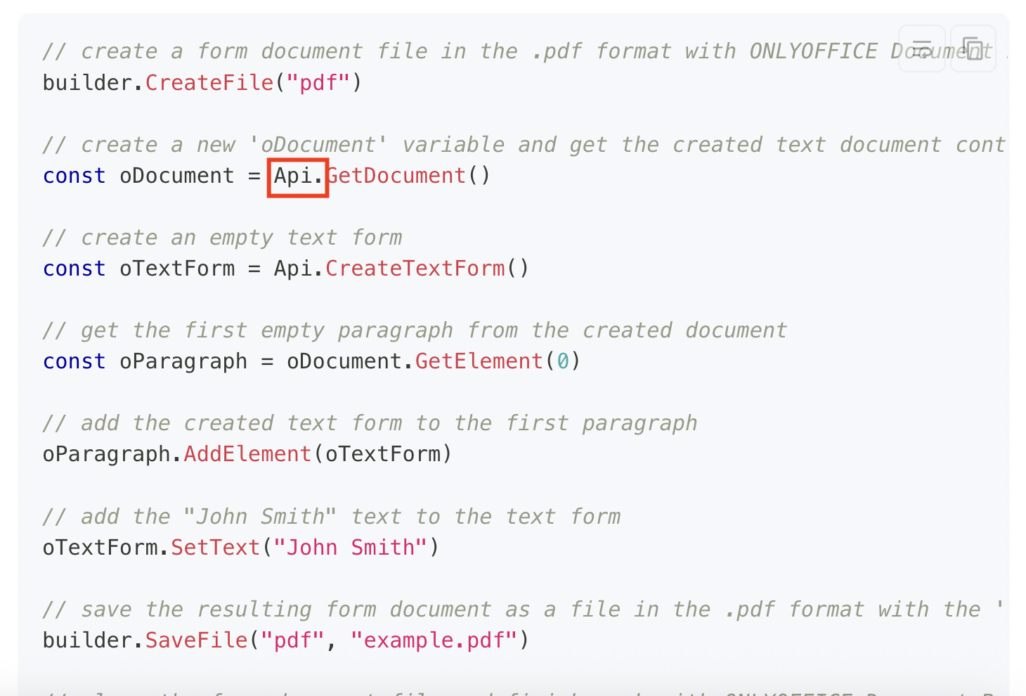

How should I then address the API class correctly?
@DmitriiV
I don’t understand how to properly access methods because all entities that I have at my disposal return undefined
Could you please send me a mini example of a simple call to any function that I could use as a starting point?
Hello @Anton2
As my colleague has mentioned, there are no methods for interacting with PDF editor yet. It means that there is no Api class that would represent a set of features that are available for editing a PDF file.
Moreover, it is not clear what you have tried in your test and what exactly returns undefined. For instance,

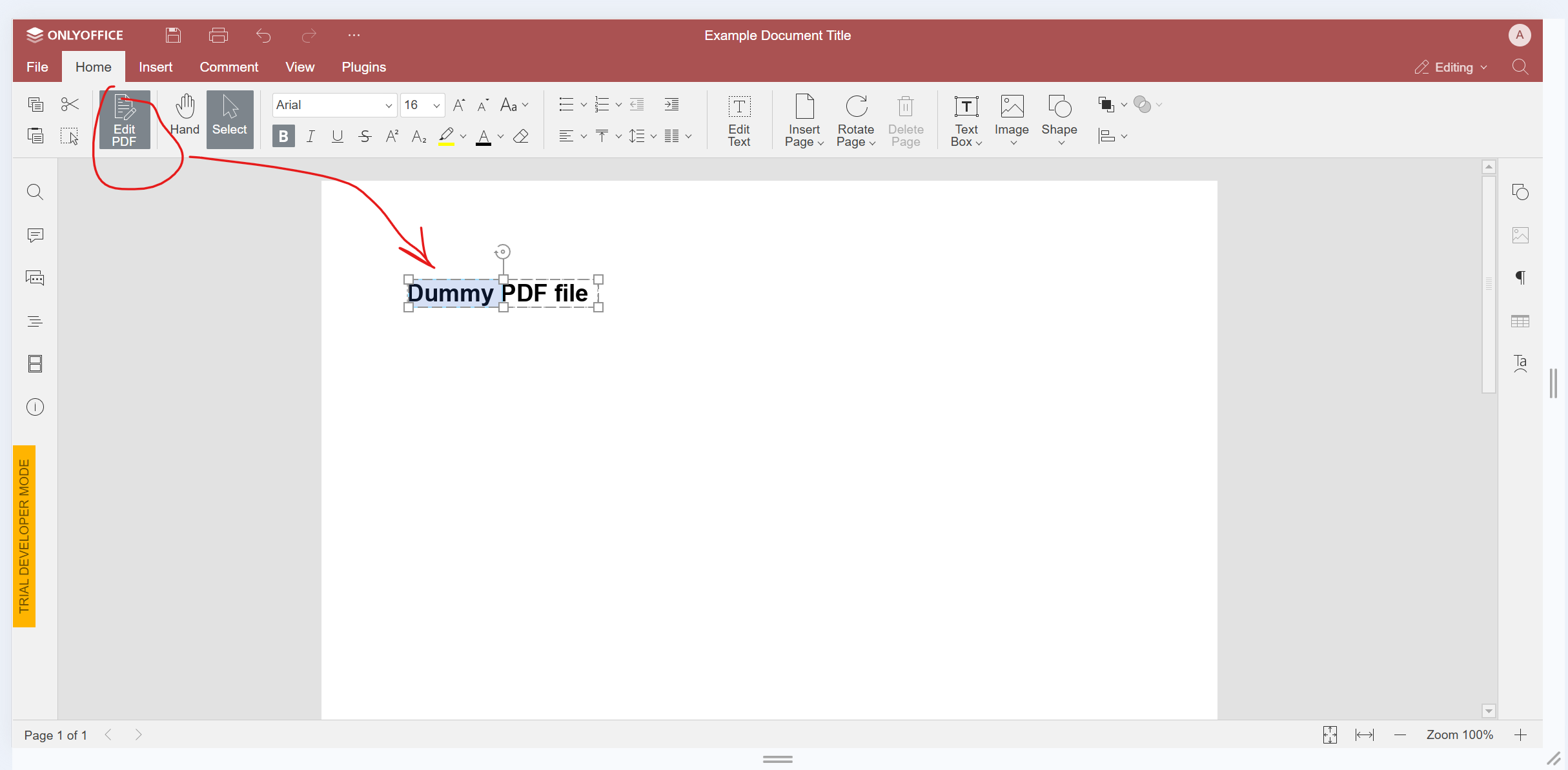

So, there is no way to edit PDF text (e.g. replace “Dummy” with “Real”) programmatically? But how the Editor itself can do it?
Hello @vermus
Various sets of API methods exist for editors that work with XML files (DOCX, XLSX, PPTX), but regular PDF files are more complex that that. For PDF, unfortunately, such methods are not yet available.
