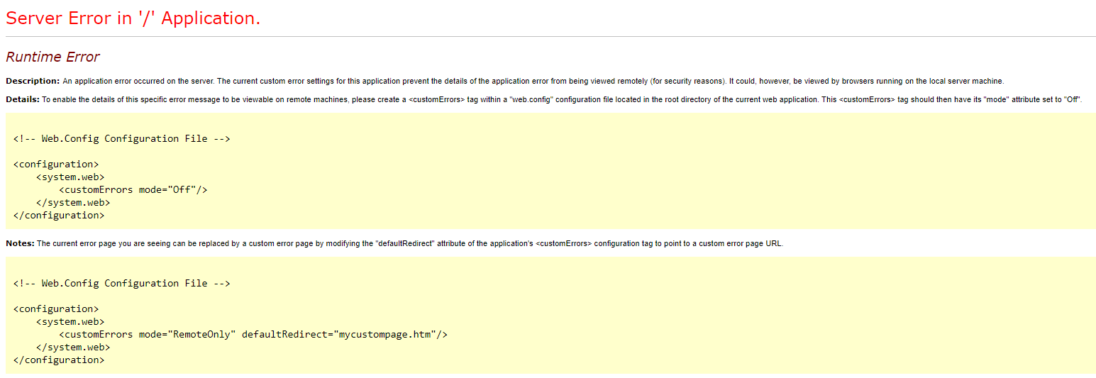

For instance, when the Document Server tries to send a status-2 message (file is ready to be saved) to the callback handler, in some cases it receives the following HTML page as a response:
But most of the time the callback handler is just inaccessible for the Document Server - Error: Invalid URI "http:/172.16.16.8:4040/url-to-callback.ashx"
