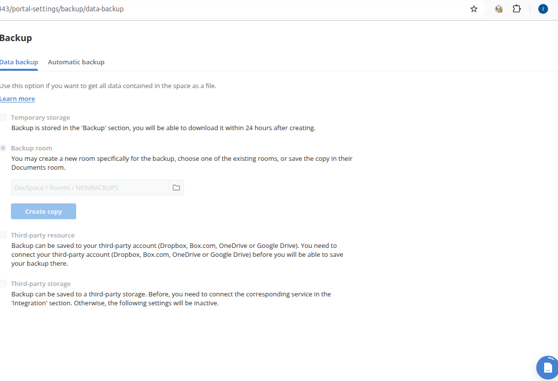

Unable to launch on demand backup of space
Docker install of Docspace.
Options to launch backup to an already defined room “Backups” greyed out.
Help appreciated.

So, the backup tabs were greyed out for around 20hrs but about 15 minutes ago they became “ungreyed” though the orange modal warning about the object still popped up.
Backups may be running, but I need to debug the and understand what is causing these inabilities to fire off a backup and have it complete.
It worked perfectly for months.
What i see in UI right now
whatever data/logs you need I can help

Please check whether you are able to start the backup process with other options (backup room, third-party storage). Additionally, we will be grateful if you could provide us with entire DocSpace log folder for our checks.

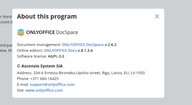

One more thing. There’s v.2.6.2 on your screenshot. Is it possible to update the installation to the latest version( v3.0.4)?
Thanks Alexandre, if you recall when I did 3.01 is when this started and I reverted to an older build (it was a clean install)
