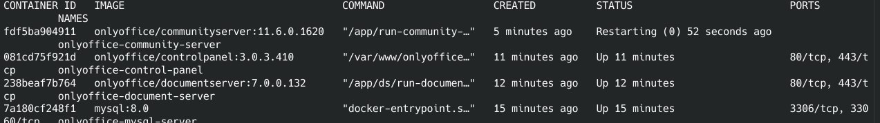

install Docker not work too. container restart every 60sec
We know about it, we discussed docker installation here: Community server container keep restarting - #6 by Alexandre
We are working on the fix for docker installation for Debian 11 too (bug number - 53124)
