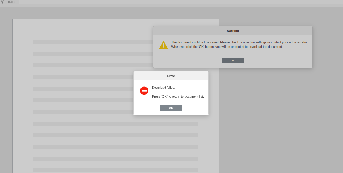

Document Server version: 7.3
Type of installation of the Document Server docker
OS: Ubuntu
Hello!
I have installed the document server from the docker hub (onlyoffice/documentserver) with docker compose, and
I am trying to connect to the “documentserver” using the example integration example.
There is a part that I cannot figure out in step 3 of the Linux installation of the integration example (ONLYOFFICE).
“Make sure that the Document Server in its turn has access to the server with the example installed with the address which you specify instead of example.com in the configuration files.”
Could you clarify which configuration files it refers to? How can I give the Document Server access to the server with the example?
When I try connecting to the example now, which is on the host machine, and the document server, that I have in a docker container, I keep getting this error.
