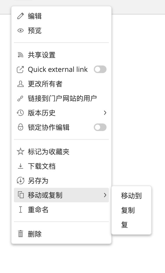

Translation error occurred in Simplified Chinese
In the workspace, using the Move or Copy function in the right-click menu, I discovered a translation error.
The correct translation for the function in the red box should be “复制到”.
The correct translation of this function in the red box should be “复制” or “创建副本”
Hello, thank you for sharing! I’ll inform you as soon as I have news on the issue mentioned.
Hello, the issue with this translation was resolved some time ago for Community Server 12.6 version, please update to 12.6 version to see for yourself.

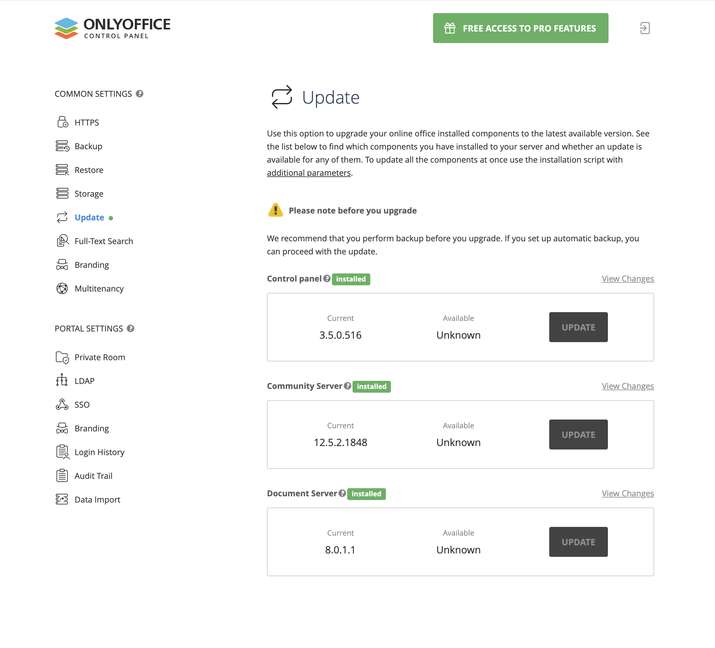

This method seems to not work well, and I also found that I cannot update from the control center.
It is like this.

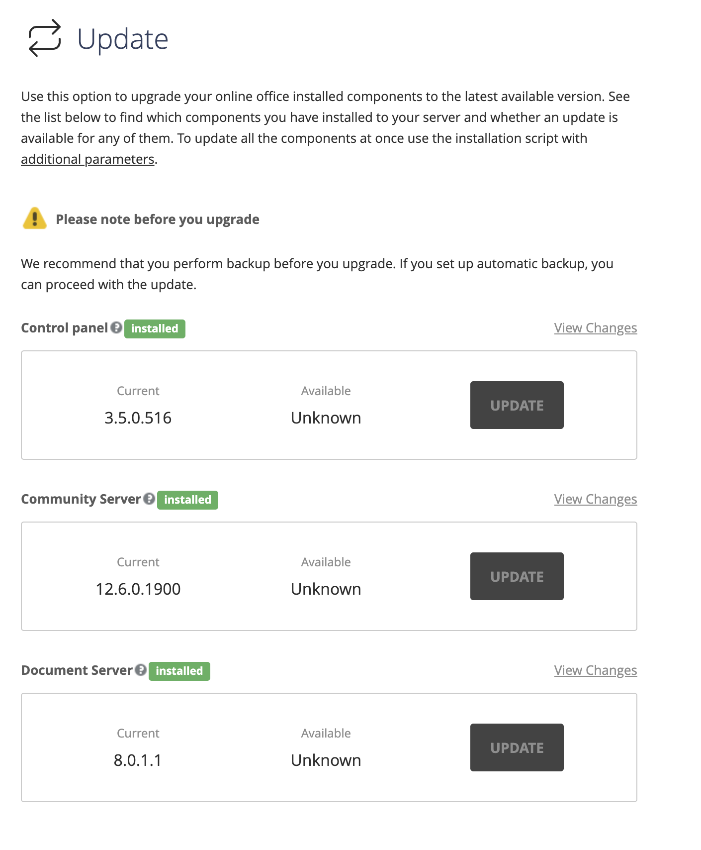

My control panel is often in this state.
