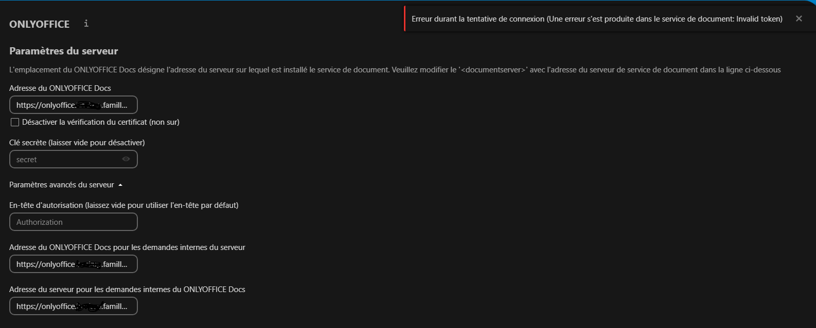

Please go to connector app and click Save button, please make a screenshot of the result (entire page). After that please collect Document server logs (you have mapped they here: /volume1/docker/onlyoffice/DocumentServer/log) and provide us with them.
Additionally, please let us know the exact version of the connector app.
Thanks,

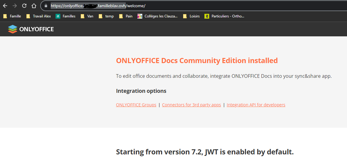

Here are the screenshots

Hello @alexb81
I see empty JWT secret on your screenshot. Did you disable JWT on the Document server side too? Please check out this setting in /etc/onlyoffice/documentserver/local.json file.

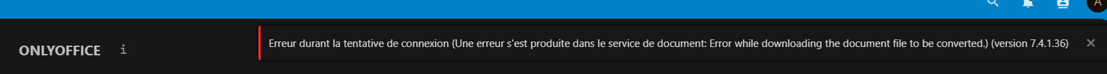

If I use zzzzzzzz:
If I use xxxxxxxxxx
Thanks

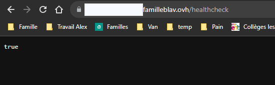

Hello @alexb81
Please execute command bash /usr/bin/documentserver-update-securelink.sh from inside the Docker container with Document Server and try connecting again specifying the value that you’ve mentioned here in Secret key field of the connector app:
The result
