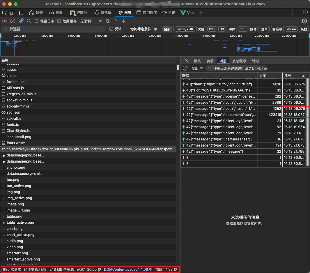

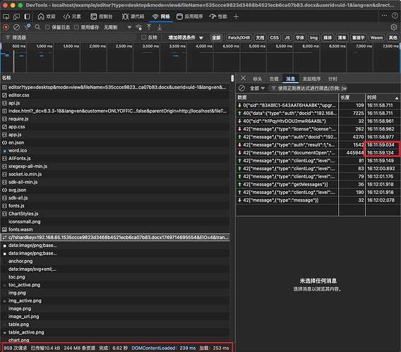

I have started a document server(Version: 8.3.3.18) in the local Docker. Previewing a remote docx file of 50-60 megabytes takes more than 15 seconds. Through the console, it is found that the WebSocket request alone occupies ten seconds, while previewing the same file through the test example only takes 3 seconds. May I ask what measures can be taken for optimization?

I created the preview project using the default template of Vue 3, and no proxy configuration was enabled.
When I directly accessed the remote file address, the file download speed was very fast, only taking 3 seconds, which proves that it should not be a network problem.

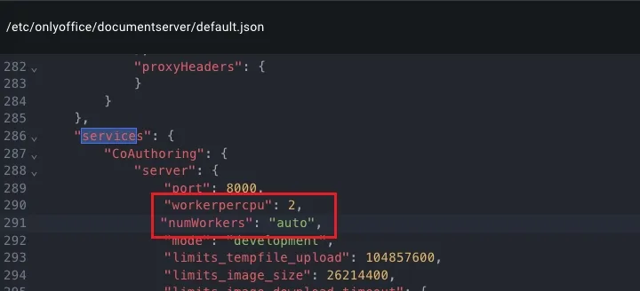

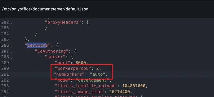

I tried to optimize the speed of the WebSocket interface by adjusting the configuration, so I modified the code of the document server’s default.json as shown in the figure, but it didn’t take effect either. I wonder if there is no such API configuration. Thank you for your reply.

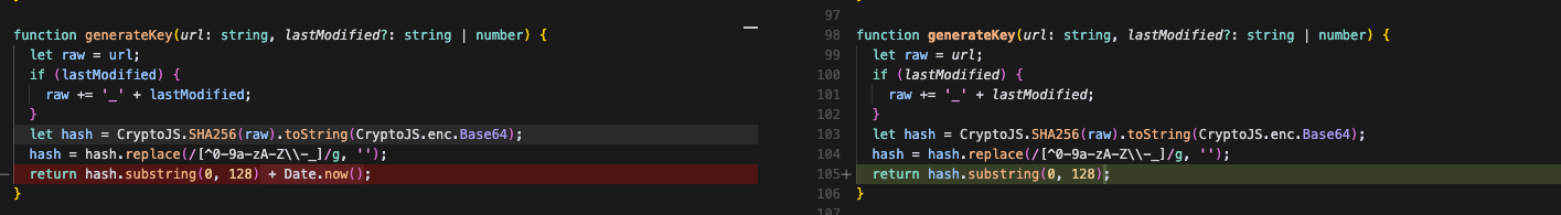

Thank you for your reply! After troubleshooting, it was found that the problem was in my code. Considering that different files need to be opened with different key values, I used a timestamp to identify the document when generating the document key value; after deleting this part of the code, the document preview speed has significantly improved. Moreover, when previewing the file for the second time, caching has been enabled, which is much faster than the first preview, taking only a few seconds to complete.
