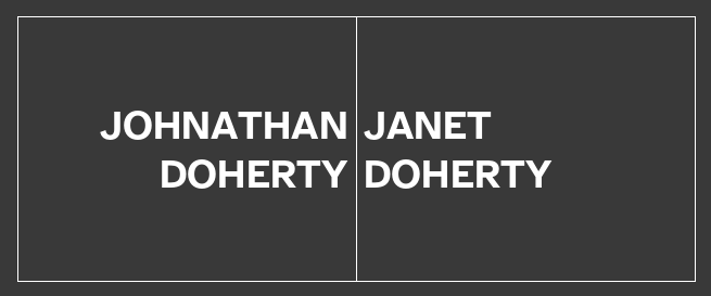

I’m sorry, but I don’t understand how OP accepted the answer as solution here.
In LO or MSO, in the text editors, when you create a table, you have the possibility to choose the vertical position of the text in the cells of the table (top, middle or bottom).
My understanding of the statement above is that the text needs to be aligned to be at or near the centre of the cell, instead of being near the top horizontal line or the bottom horizontal line. Basically, what’s shown in the screenshot below–
The accepted answer to this post is telling how to change the direction of the text in a cell, as shown below–
However, it is possible to get vertical alignment using the right-click menu also. The option is called Cell Vertical Alignment, see screenshot below–
I hope I cleared out any confusion for people seeing this in the future.
