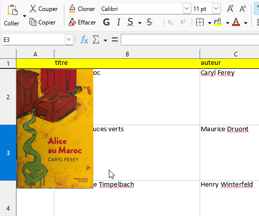

I’m making a list of books in a spreadsheet.
I want to add a picture of the cover on the line of each book.
When I insert the picture, it is bigger than the cell I’m putting it in.

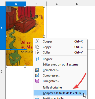

I was not aware of it but after checking, LO has that kind of functionnality:

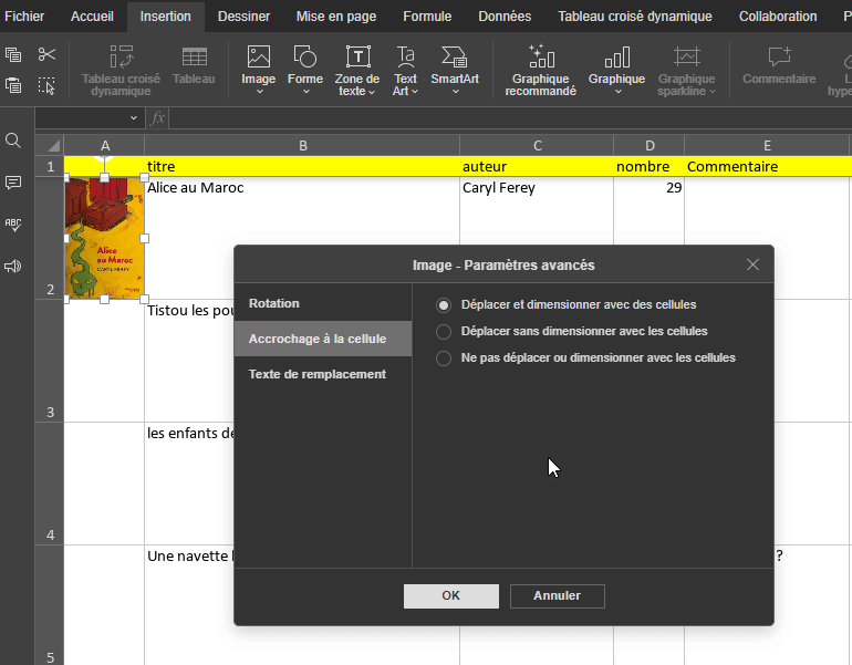

I went a little further and search in the pictures’ advanced options and found what seems to be what I’m looking for.
First comment : it is way to long to get this option. As far as I see, there is plenty of room in the sidebar for pictures options, so why hiding it behind so many clicks ?
Second comment: it looks like it is not properly working
So rather than a suggestion, I assume this is a bug
Hello again again
Went a little further in my tests and understood how things indeed work (cause they are working
Actually the picture is resized when the cell becomes smaller than the picture.

Hello @arcqus
We are taking closer look at your suggestion on add possibility to fit the image to the cell.
Please note that Cell snapping > Move and size with cells works when image is positioned above multiple cells. If the image located visually above one cell it does not change, this is expected behavior.
