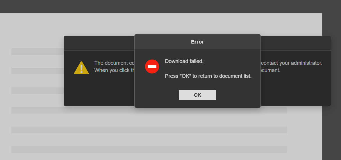

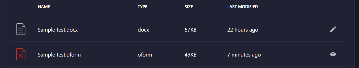

However another issue came up, i can open up docx files, but i cant open oform and docxf files.
When i try to open the .oform file i see this:
This is what i get in strapi logs
Hello @georgkivivali
Sorry for the late reply.
We are glad that you solved IP addresses issue.
As for docxf\oform files support, unfortunately Strapi integration doesn’t support these file formats at the moment.
Please accept our sincere apologies.
