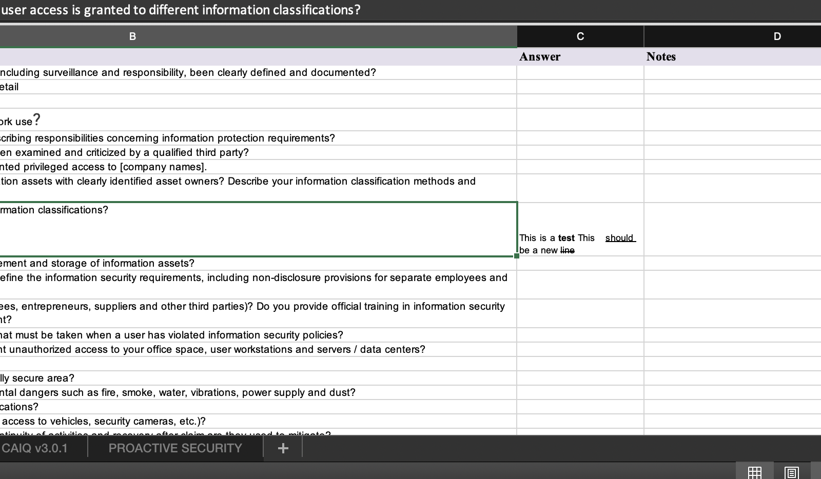

So we are using the PasteHtml executeMethod to paste html in the editor with a loop script.
For example:
This is a test
This should be a new line
If we do this we get the following:

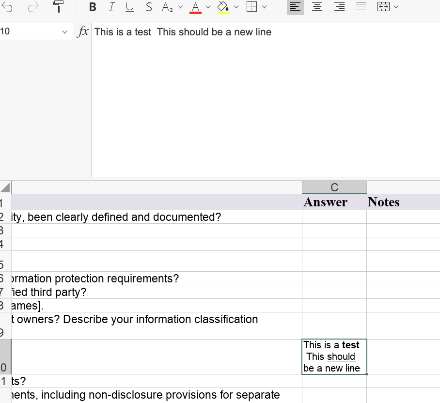

As you can see the text is spread over 2 cells because of the

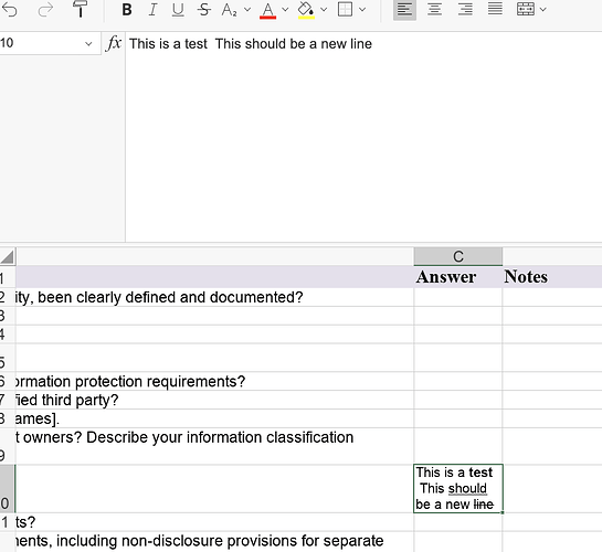

After long time of trial and error I found if we transform the
to unicode \u2028 the line break is set as it should
This is a test\u2028 This should be a new line

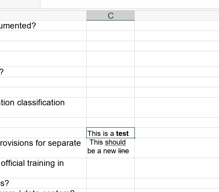

But as you can see in the formula the line break isn’t taken over. And thus if we download the file, it’s not on a separate line:
This is really annoying as the customer loses his structure.
Am I doing something wrong or?
Kind regards,
Laurens (Sequesto)

If we use the unicode character above in the code it will work fine visually in the spreadsheet editor, however on download of the file and opening it on your desktop the line breaks will be gone and this is probably because the unicode is not really picked up by excel and excel expects a \n instead.
When we do alt + enter in a cell I can see that it is represented by a \n by only office, but how can we paste html and have a proper \n in there which works visually on the spreadsheet editor, but also after downloading?
