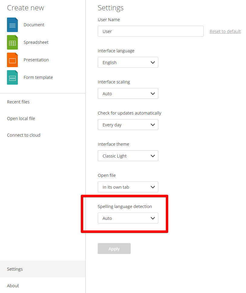

To avoid problems with spellchecker language change you can set “Spelling language detection” setting to Disabled in the Settings menu of the application.
Hope it solves your problem.

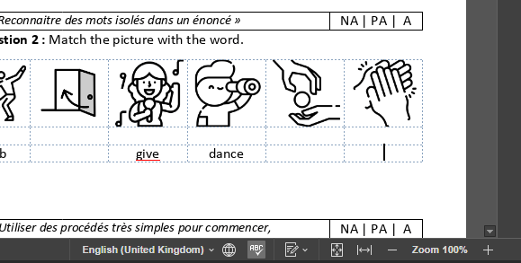

To me there should be some kind of “pause” before the spell checking language is changed, in order to evaluate the used language once some word have been typed.
Just to show you what it looks like:
