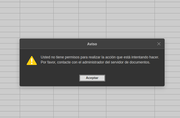

Some times the Admin users can not modify a
Do you want to: When trying to edit a document with the Administrator user, sometimes with no pattern I get the following error:
Translated:
You do not have permissions to perform the action you are trying to do.
Please contact the document server administrator.
After that message appears, all the interface becomes lighter and I am not allowed to use anything but Download/Print… it is like having only Read permissions.

This error occurs when trying to edit the document and you type something. If not, the error does not appears.

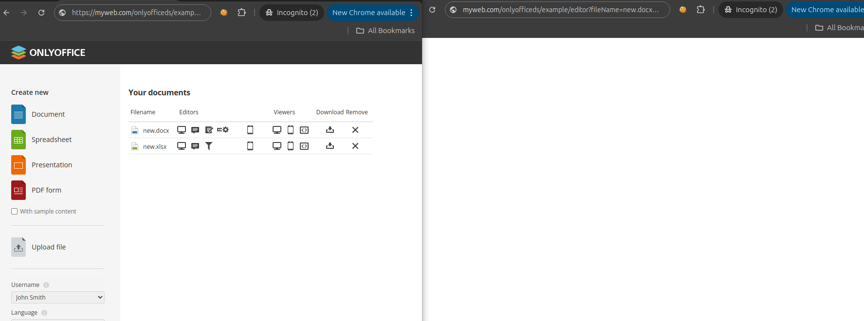

4. Do you have any issues with editing files from integrated test example?
When creating a file and trying to access I get a blank page:
The logs after trying to access:

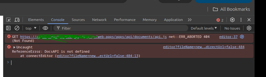

A possible reason I have blank page is because this resource can not be loaded:
Sorry for second message but I can not attach 2 images for now :confused: .
This error could mean that Document Servers’ address was changed or defined incorrectly. Considering that integrated test example returns such result, please try creating new file again and then share logs of Document Server.
In general, we haven’t tested deployment in such environment.
