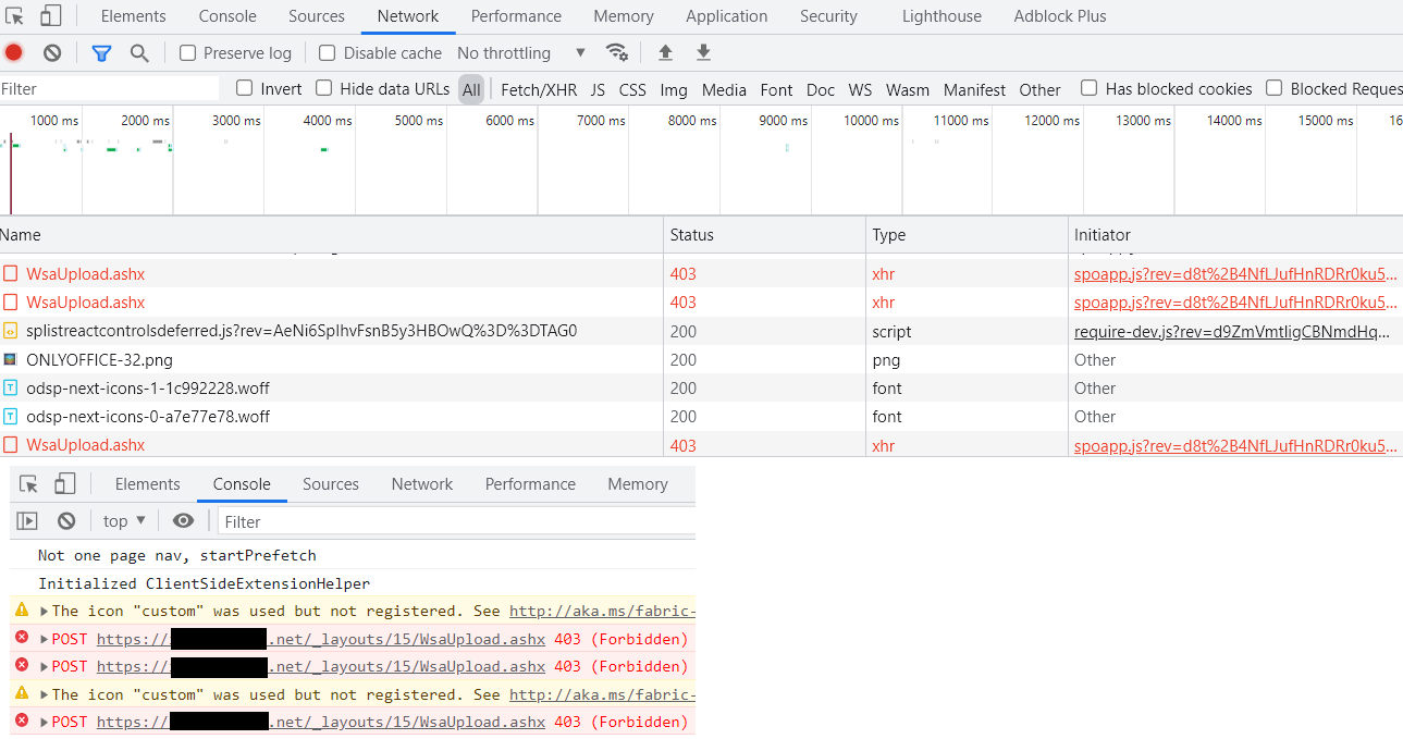

  3. Please make a test. Open a file for editing with open browser console:
  • Open browser console (for example, F12 in Chrome) → choose ‘Network’ tab in browser console → open file for editing → check if there are any error entries in console and send us a screenshot;
  • Choose ‘Console’ tab in browser console → open file for editing → check if there are any error entries in console and send us a screenshot.

  3. Yes there is some POST 403 errors, screenshots :
No on Onlyoffice editing web-interface, there is no errors
