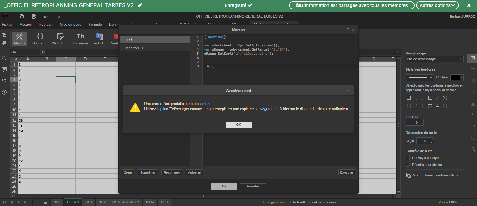

So i tried to write this :
(function()
var oWorksheet = Api.GetActiveSheet();
var oRange = oWorksheet.GetRange(“A1:A24”);
oRange.SetSort(“1”,“xlAscending”);
The system well executes the macro, but is crashing immediately after
Can anyone helps me ? Is a probleme in the parameters of the method SetSort ?

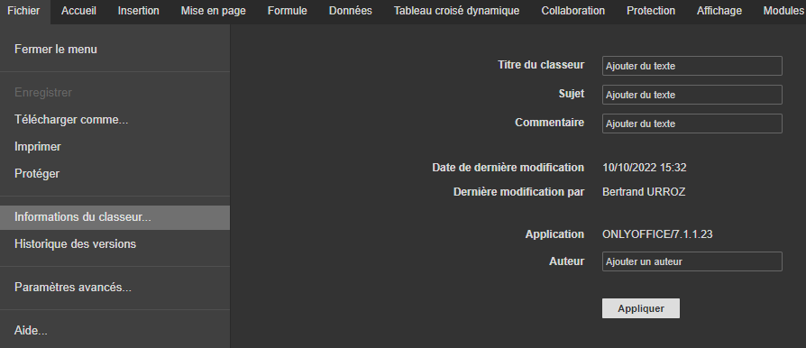

Hi, thanks a lot for responding
Here the screen of the information page
I tried again, the problem still being : Monosnap
It would be great if it would work :pray:
Thks again
Hello @Bertrand
As far as I see, you use v.7.1.1. Could you please update your app and re-check the situation?
