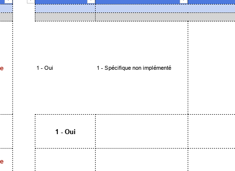

So the issue we have is that if the cell has some layout (border, font size, font family, etc…) it isn’t taken over and it’s completely lost which is too bad as it screws up the spreadsheet of our customers.
As you can see in this screenshot:
Screenshot 2025-05-28 at 09.37.46
(first row is with our script, the row below is when we select an option from the dropdown)
Test file.xlsx (21.4 KB)
