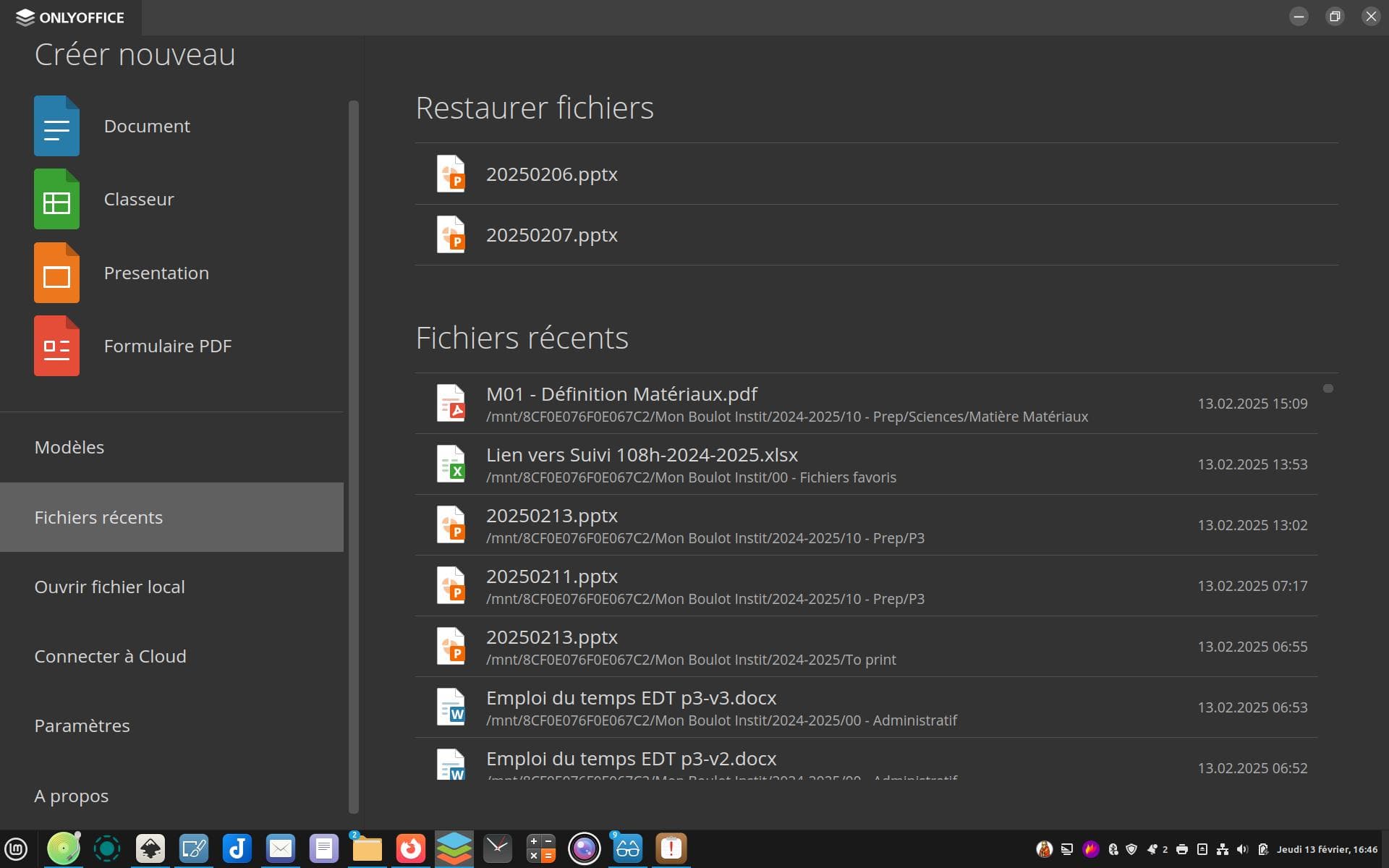

Things are a little less smooth than with windows.
Today, connecting my computer to a video projector, I needed to change the screen resolution.
I choose a poorer resolution and all apps UI objects got bigger (normal).
However, when I switched back to a sharper resolution, all apps but OO went back to normal.
I uninstalled it, but it is still the same.

In addition, when I connect my laptop to my external screen:
  • on the external screen, the resolution of OO’s UI is “normal”,
  • on the laptop’s screen, the resolution is still low/UI elements are very big.

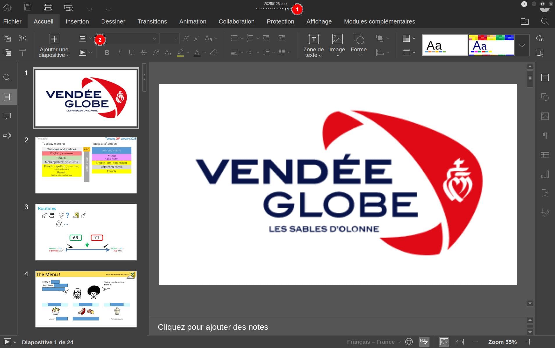

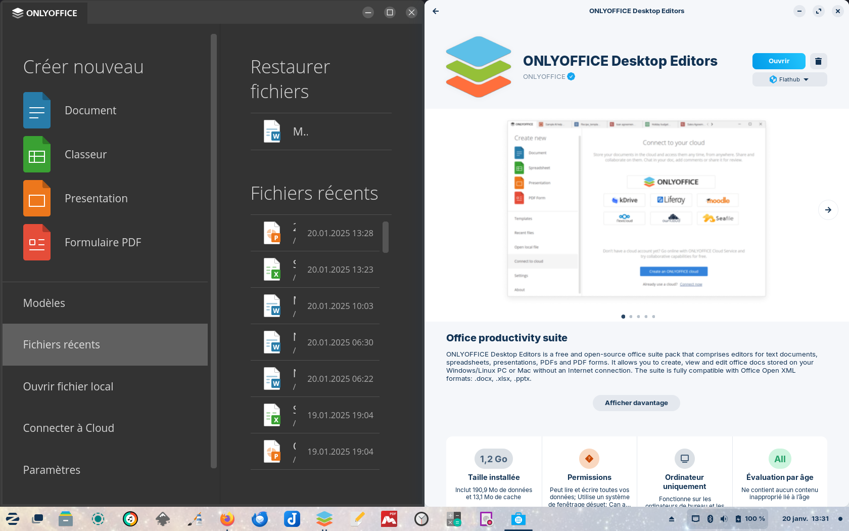

  1. I removed the package and installed the .deb for OO’s website.
  2. unfortunately, I instantly got the same issue:
    When OO is displayed on the laptop screen:
    As you can see, the title bar has a “normal” resolution (1), but all UI elements are big like on a low res scree.
    When the laptop is not connected to an external screen, this back-to-the-90s UI is not my cup of tea :slight_smile:
When OO is displayed on my external screen, everything is fine:
