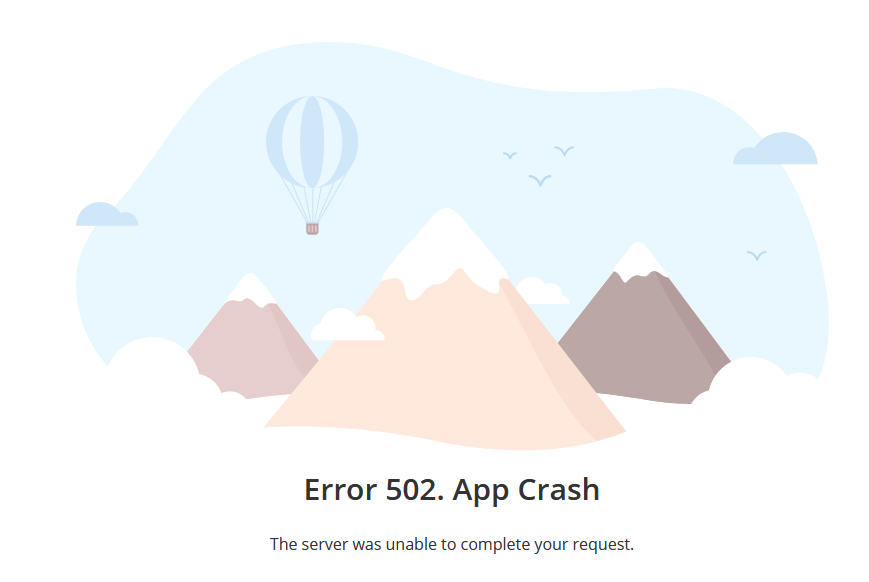

But in fact on web interface again there is an error:
Error 502. App Crash
The server was unable to complete your request
So i stucked again(
Maybe you can say what is the problem? Maybe after script installation i need some aditional actions? Maybe problem with mysql? Because no database “onlyoffice” created. I have installed mysql 8.0 before running script. Maybe onlyoffice don’t know where to get root password for mysql? I will try again to install onlyoffice , but not to install mysql before and i will give you an answer later.
Please note that we always recommend to use totally clean server for installation process. It’s necessary to avoid dependency and port conflicts. In case of using installation script, the script will install all necessary components. Please reproduce your installation test with clean OS.
By the way, about SELinux (you mentioned it before). You can face the issue which is related to Centos 7 minimal installation and SELinux. We have description about it here in “CentOS issues” category: Troubleshooting. Server Solution - ONLYOFFICE
Probably it will be handy.
Great! Thank you so much!
I even did not disabled selinux. Only installed wget and script done everything, that i wanted. Right now server works correctly and i even can see backup menu in control pannel. So i will write in topic about it, when i will check all functions.
