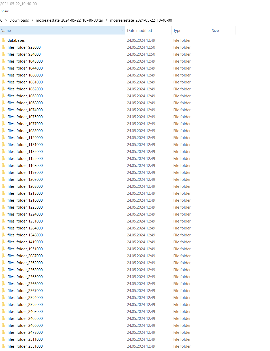

Could you please try to open the backup file with any archive utility (e.g. 7zip)? Can it be opened correctly with no errors? We suppose the backup file is corrupt in your case.
@Carl yes, I did this before restoration via 7z - everything is fine
Could you please make a screenshot of the file’s content?
