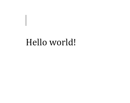

I followed your recommendations and this is what I got:
Source file
Final file:
Code:

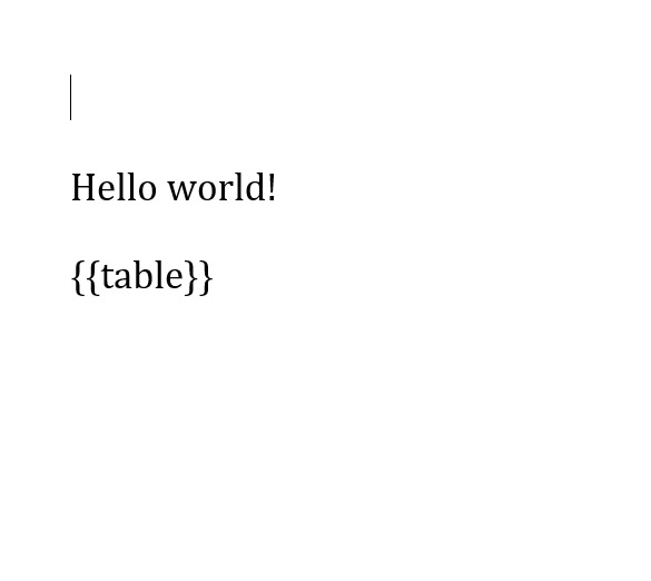

I changed the code as per your advice. And here is what I got.
source file
final file
Apparently the carriage is not moving

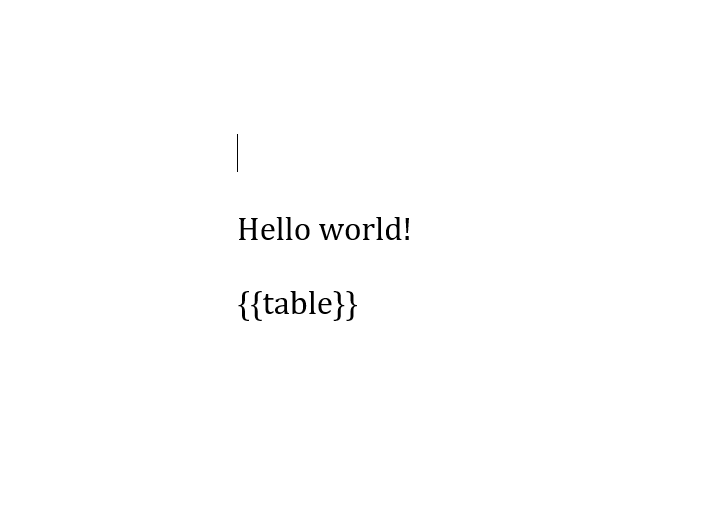

after i used select the table disappeared completely
source file:
final file:
code:

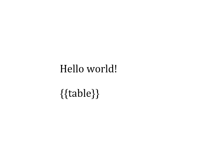

I’m trying this.
Source file
Final file
Code:
