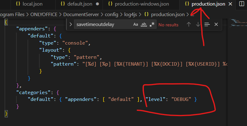

Please enable debug level logging for Document Server and check logs for additional information. Document Server logs events such as processes of saving the file, so you will be able to check out whether Document Server sends anything to the callback after all.
To enable debug logging you need to access production.json config in C:\Program Files\ONLYOFFICE\DocumentServer\config\log4js directory, change "level": "WARN" to "level": "DEBUG" and then restart Document Server services in Windows Services to apply the change. Then reproduce the issue and check out logs in C:\Program Files\ONLYOFFICE\DocumentServer\Log.
i do this
and make restart to services after that
