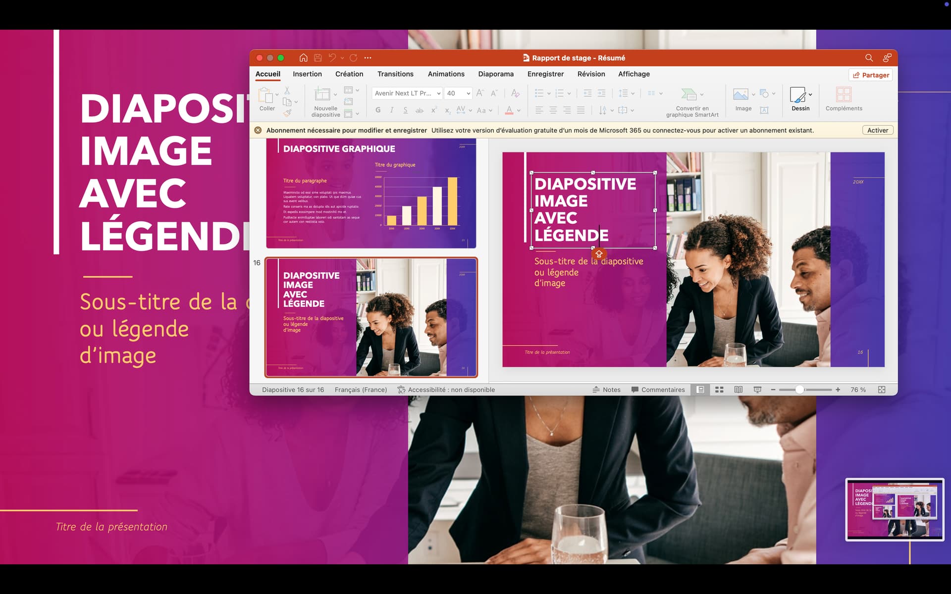

As you can see in the first photo, if you launch PowerPoint’s presenter mode and open the preview of all open windows, you can select two windows: the presenter view and the ‘normal’ PowerPoint.
Therefore, you can modify the live presentation.
It’s often necessary to make modifications, and it allows you to stay in presentation mode without having to exit and re-enter.

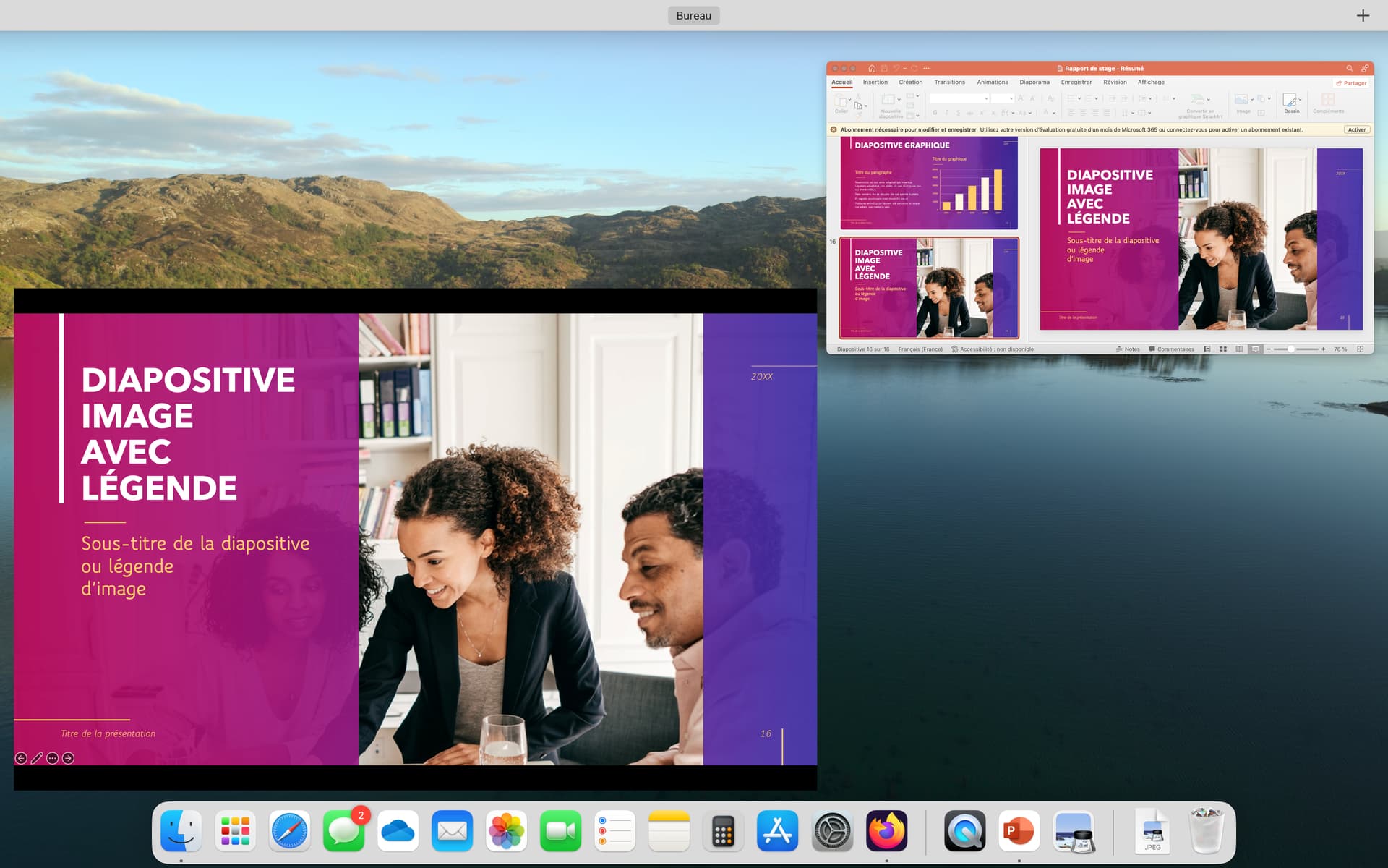

Or you can still leave a slide on the screen, but edit the next one before it is displayed to everyone.
This is very very useful !
Note 1: For this to work in PowerPoint, before launching the presentation mode, PowerPoint must not be in full-screen mode (you can switch to full-screen mode afterward, but if you do it before entering presentation mode, you won’t be able to select the first window).
Note 2: I haven’t found this possibility either in Keynote or LibreOffice.
Thank you !
The second photo where you can modify the live presentation.
OP is correct, with PowerPoint in presenter mode, the original editor window is still open, and you can switch task (such as Alt-Tab) back to it to make changes.
Libreoffice supports this also. Its presenter window opens separately so the original editor window is still there in the background. If you switch to it, you can make changes to any slide and they will be reflected in the active slideshow.
I have wished for this feature as well. If I notice something that needs to be changed, the changes can be made on the fly, rather than exiting out of the slideshow or waiting until later.
