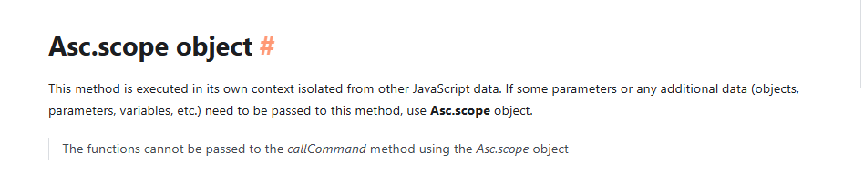

As shown in the attached image, we can’t pass a custom function through Asc.scope. However, I still want to pass a function into callCommand. How can I achieve that?
Hello @ZangHoang,
Unfortunately, there is no way to pass a custom function to callCommand.
What is the use-case scenario?
Additionally, provide an example of the function that you’d like to pass - for reference
Just pass function as string and then use eval().
@malubimcev Thank you for sharing, it is indeed a good workaround
just a basic pure function to calculate something, instead of re-define them again and again inside callCommand I just want to re-use it.
Understood. The only option here would be the workaround suggested above
using eval() as malubimcev told is a good point. So I’m gonna go with that.
