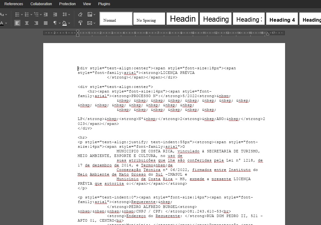

I’m trying this code, as per your guidance, informing the documentType as word.
The file was opened in the editor, but as if editing its code. I would like the html to be rendered, so I can edit and save it to docx.
See my Screenshot.

Please note that the file should contain html format markers according to specification, there are no tags can be seen such as <html>, <head>, <body>
, etc. in your html document. You can refer to this html specification: HTML Standard
Hello DmitriiV, thank you very much, this was the problem. Now it’s working.
