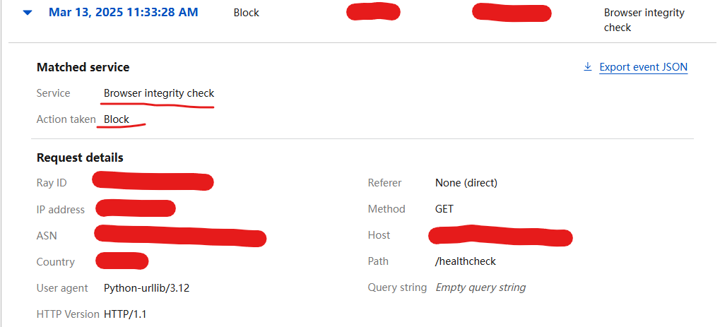

I had the same problem. All you need is to create a rule in WAF to skip Browser Integrity Check for your healthcheck request.
If you checked in your WAF events page, you should see something similar to this :
Hope that helps.
