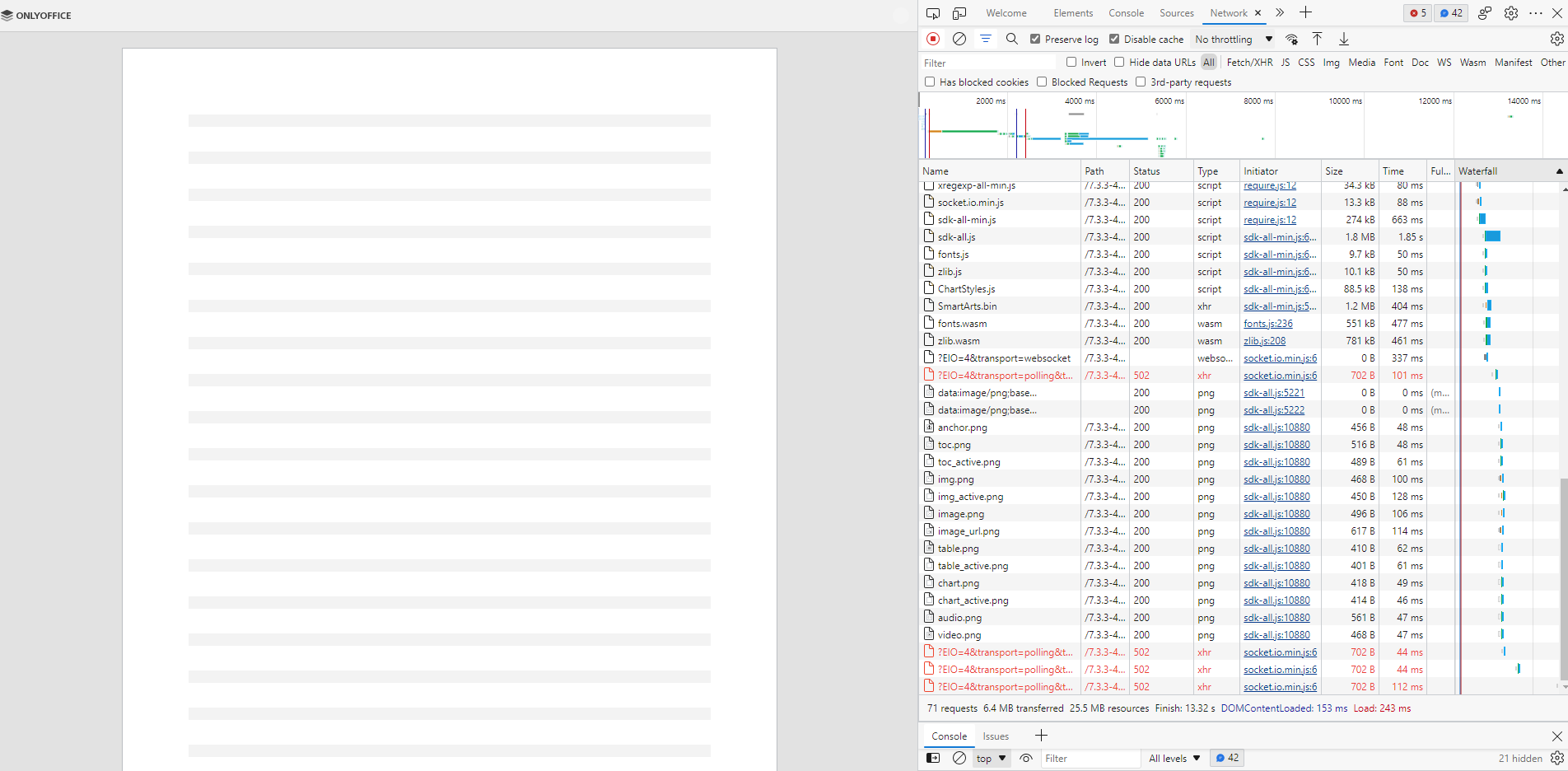

Now for the problem. My problem is that while locally OnlyOffice works perfectly fine, i can not make it work on azure (I have tried 3 different hosting platforms, and all of them did not work. I tried web apps, virtual machine and container instance). While front page works, that you have discovered, /healthcheck does not. My main problem is that when oform is opening websocket endpoint gives same 502 error.
And because of that error file will not open and eventually this message will pop up.
Here are errors that I see in docker console, when I receive this 502 errors.
