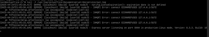

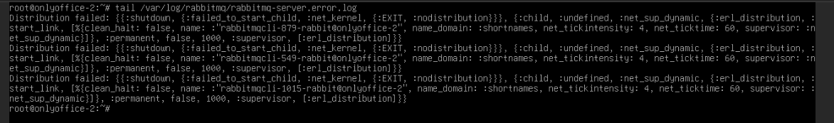

In onlyoffice server i saw this error:
Try on fresh install, new VM, install by script, same error

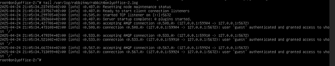

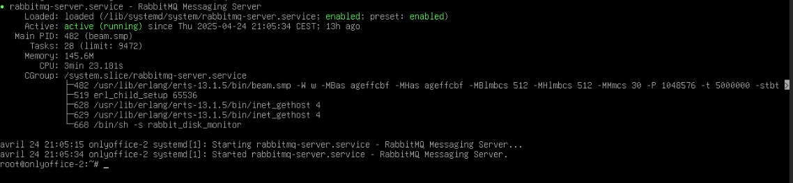

5672 port is used by rabbitmq service, it seems the issue is related to it, please provide the following:
  1. service rabbitmq-server status command’s output
  2. netstat -tulpn | grep 5672
  3. Rabbitmq logs:/var/log/rabbitmq (for Docker - inside the container)
  4. local.json (/etc/onlyoffice/documentserver/local.json)
