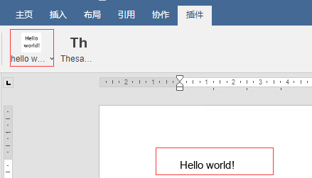

problem:I downloaded Hello World in the plugin example,And add it to my designer,But when I open the designer, the Hello World plugin runs automatically,I try to add other plugins, which will run automatically,image

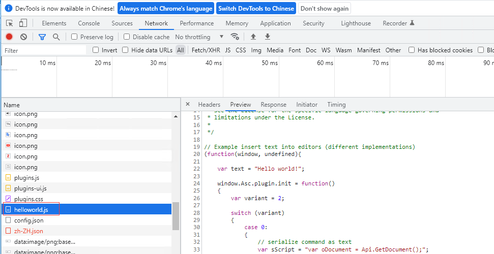

Through debugging, it is found that the HelloWorld script is loaded when the page is running
However, other default plugins are not loaded

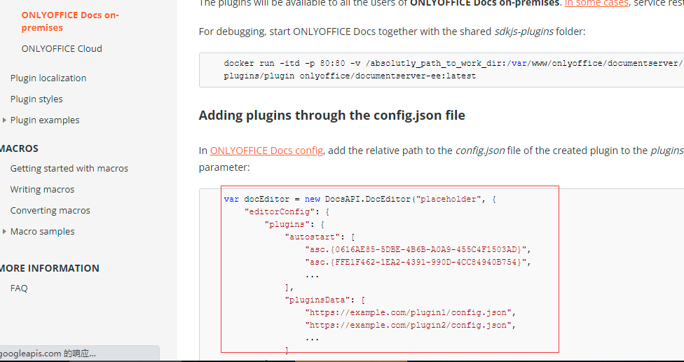

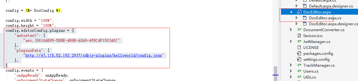

I found it was plugins The problem caused by plugins.autostart attribute. After adding this attribute, the plugin will run by default. This function is not reflected in the document
Do you mean this parameter? ONLYOFFICE Api Documentation - Config
Yes, it’s related to autostart.
