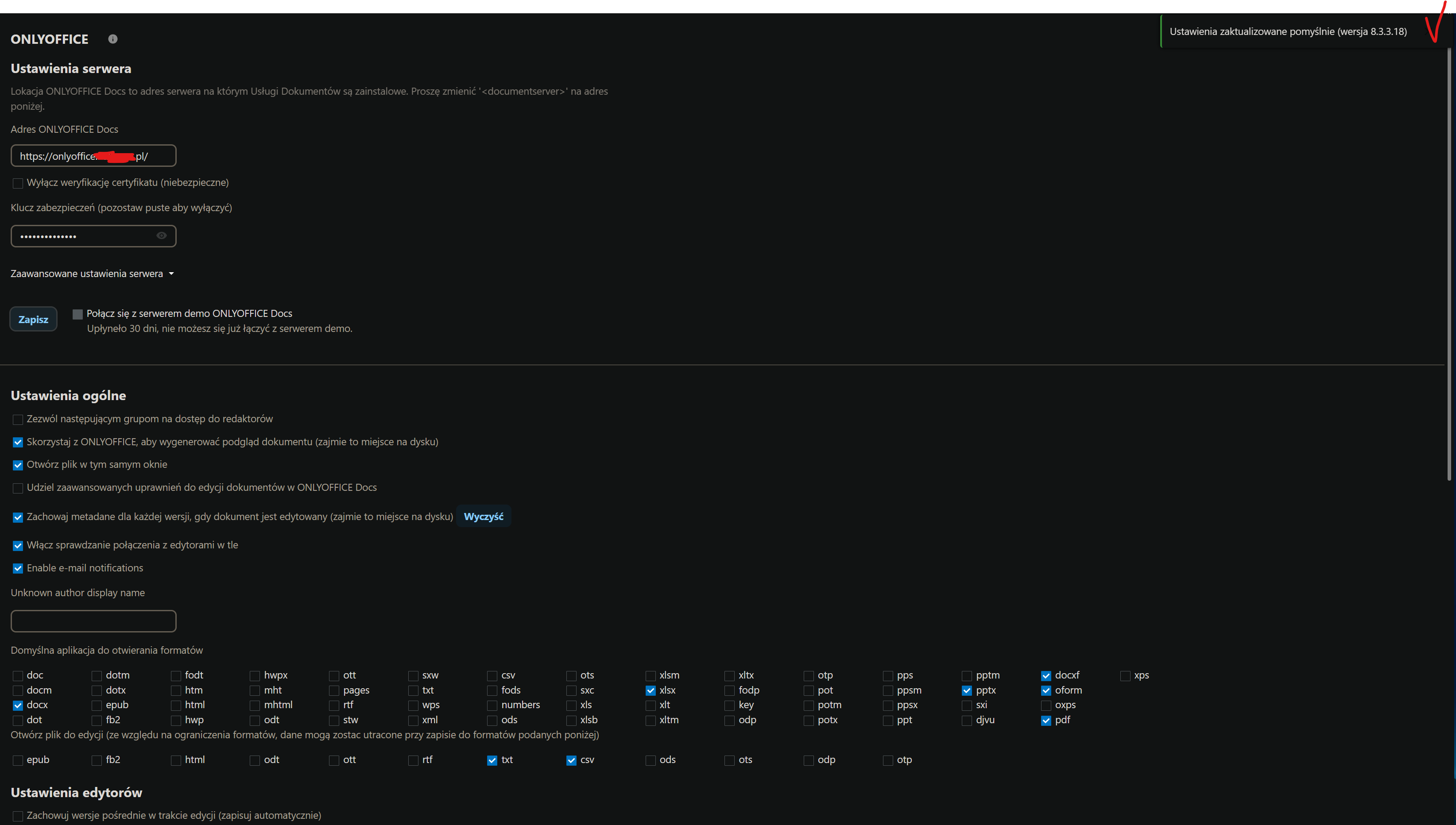

I have the correct connection:

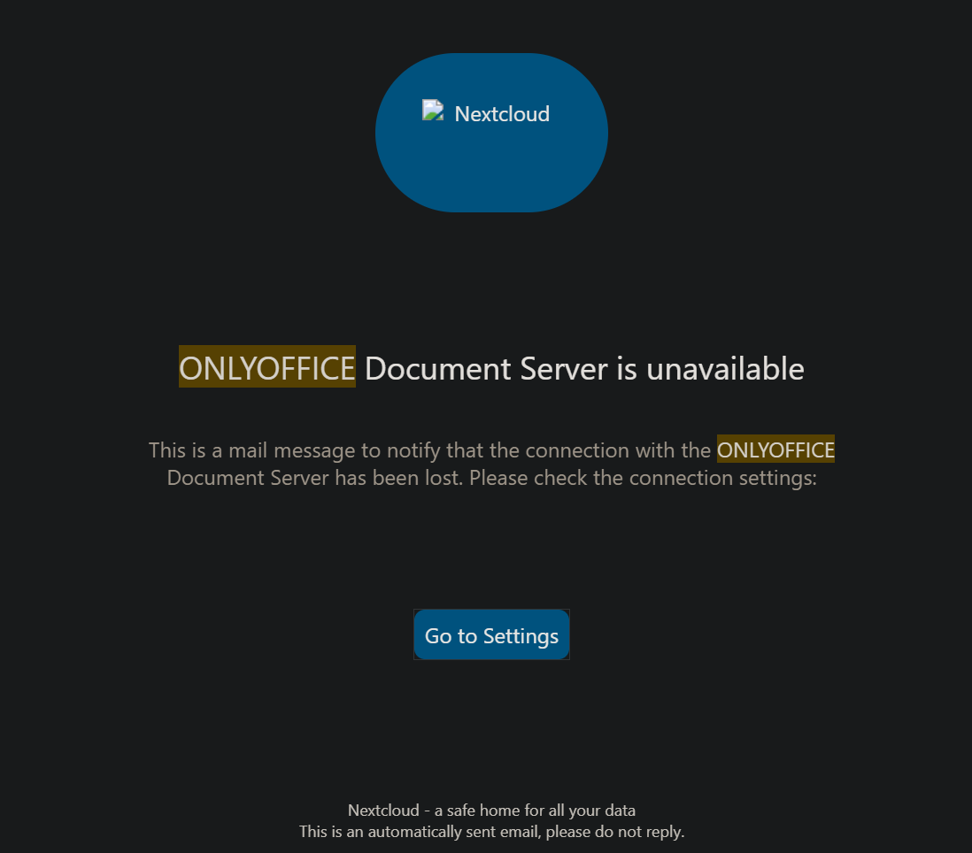

The next day he receives a message:

In NextCloud logs I have a message with an error after receiving the message.
Exception
Error occurred in the document service: Error while downloading the document file to be converted.
getConvertedUri on check error
