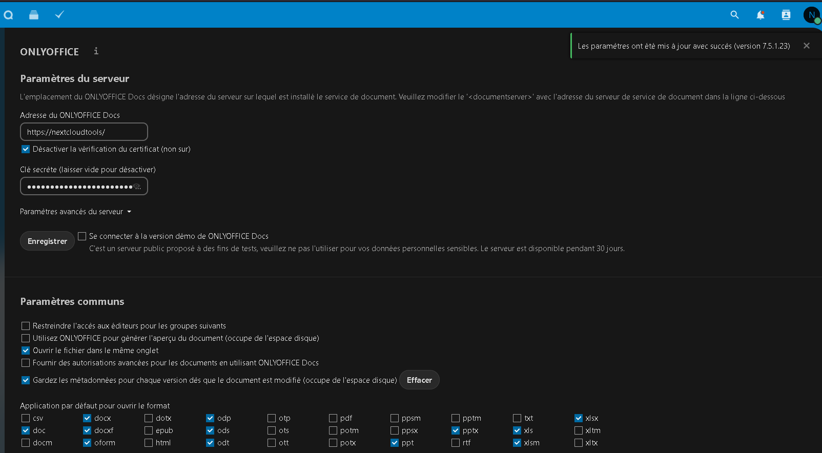

I have been able to connect nextcloud with onlyoffice connector + token I’m using https protocol with the private ip adress of the onlyoffice server.
The nextcloud interface tells me that everything is ok but when I’m trying to open a document I have this message: “ONLYOFFICE is unavailable. Please contact your administrator”.

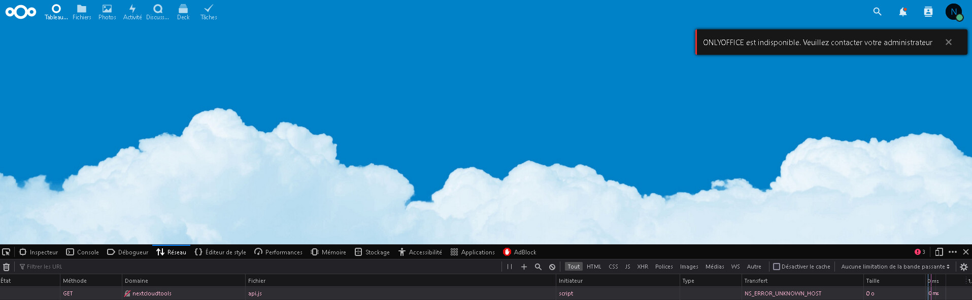

When I try to inspect with developer tools of the browser, I can see that the URL that I’ve configured in the onlyoffice connector is HTTP and not HTTPS.

Here is a screenshot of the developer tools that showing the http connection to the onlyoffice server:
