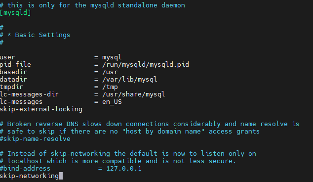

Probably the described issue from your posts is related to some restriction of TCP/IP connections or some changed settings of MariaDB since the issue doesn’t reproduce on clean server with the installation from scratch. We tried to check out this scenario and added skip-networking to /etc/mysql/mariadb.conf.d/50-server.cnf and then systemctl restart mariadb

So I feel I owe you an apology for wasting your time – there must have been some MariaDB configuration on the old server causing the issue, however I’m still unsure what that was.
We are glad to have helped.
Unfortunately, I’m not sure how to troubleshoot your old server (MariaDB) and what could be the problem. Probably it’s better to deploy your installation on a clean server to avoid dependencies and settings conflicts.
Thanks again @Alexandre, I have tracked down the setting that was preventing connections to 127.0.0.1 but allowing them to localhost – it was a systemd setting I had added to a /etc/systemd/system/mariadb.service.d/mariadb.conf file I created ages ago and forgot about :roll_eyes: :
