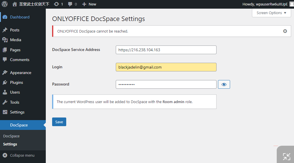

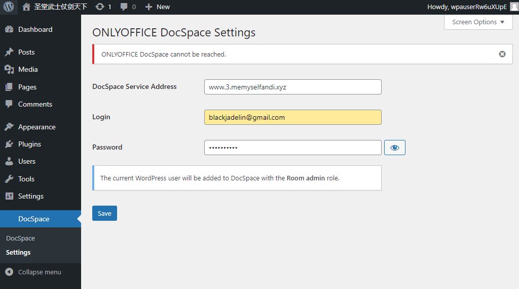

I am trying to integrate ONLYOFFICE DocSpace into WordPress website using the ONLYDOFFICE DocSpace connector.
referring to your page:
Embed documents and folders into your WordPress website using the ONLYOFFICE DocSpace connector
after all things installed, in the configuration page, I input my OODS server url, but:
ONLYOFFICE DocSpace can not be reached

both WP and OODS sites are ok and online internet, but in the initialization settings for the connector, I don’t know, why it can not reach the OODS URL?
Hello @VincentYoung
Please try specifying DocSpace Service Address parameter as http://3.memyselfandi.xyz/
I have tried that, the same error
ONLYOFFICE DocSpace cannot be reached.

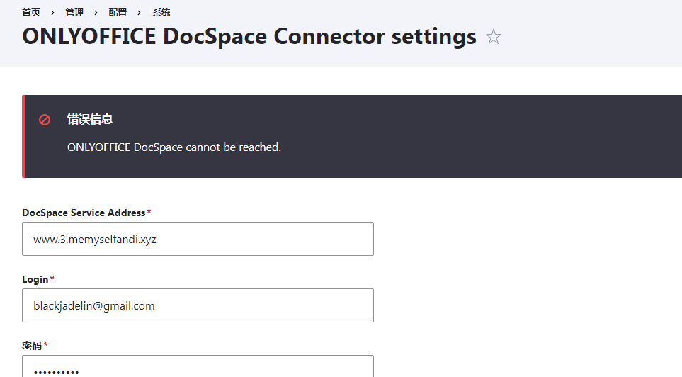

I have deployed another server of Drupal, and installed the connector between Drupal and ONLYOFFICE DocSpace server, and in the configuration page, again, the same error:
I have also tried input of
http://3.memyselfandi.xyz,
https://3.memyselfandi.xyz and
https://www.3.memyselfandi.xyz, all the same error
The login input is my ONLYOFFICE DocSpace website’s administrator account and its password.

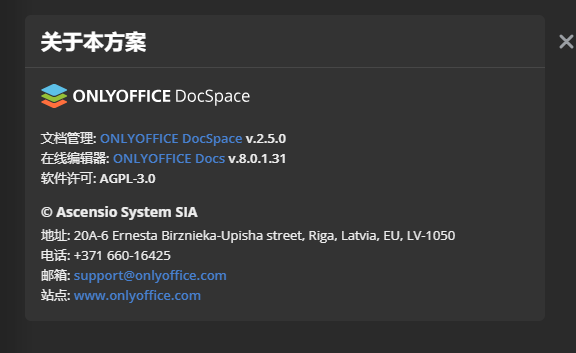

The ONLYOFFICE DocSpace Server version on the
is 2.5.0

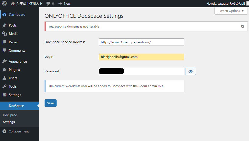

Please try additionally specifying DocSpace Service Address with dash on the end and https, e.g. like https://www.3.memyselfandi.xyz/
If it does not connect, please let me know OS types and versions of servers where DocSpace and WordPress are installed.
I got a new error information:
res.response.domains is not iterable
with the address:

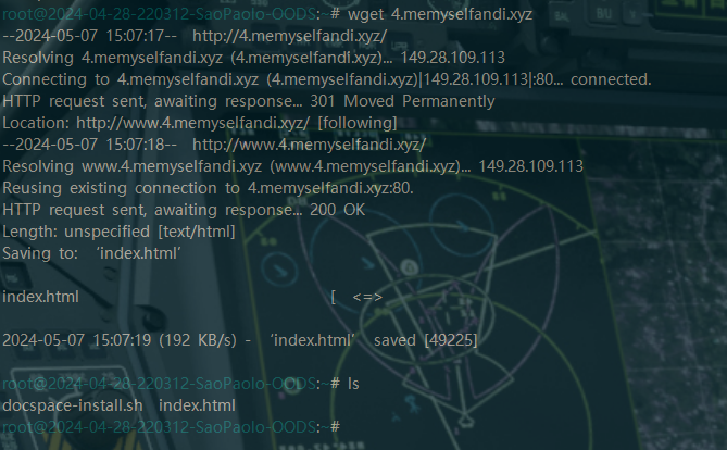

Just to make sure that both servers are mutually available please execute wget <address>
from each server to another and provide outputs.
Here come:
wget from DS server to WP server:
![from3to4](https://forum.onlyoffice.com/uploads/default/original/2X/a/a50de6306d5e9cdbc26645da19d5fcb232c01942.png)
wget from WP server to DS server:

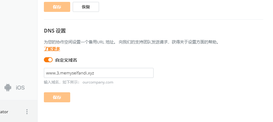

I checked again my settings in the DocSpace server, noticed that I have switched on the configured domain:
should I switch it off?

the same error:

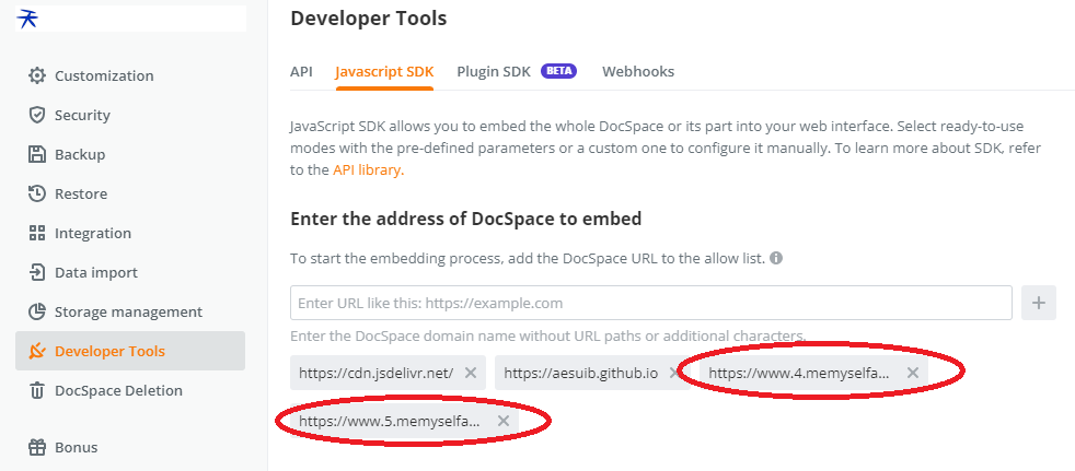

Here, in my OO DS Server, I enter the addresses of my WordPress server and of my Drupal server to the allow list, then, back to my connector initial setting pages in WP server and Drupal server, input my OO server domain https://www.3.memyselfandi.xyz and site master’s account name and password, and save, they will success go to the next step.
what step I missed to do is the allow list in the OO server settings page, and this information is not covered in your manual here:
Thank you for the help all this thread of post!
