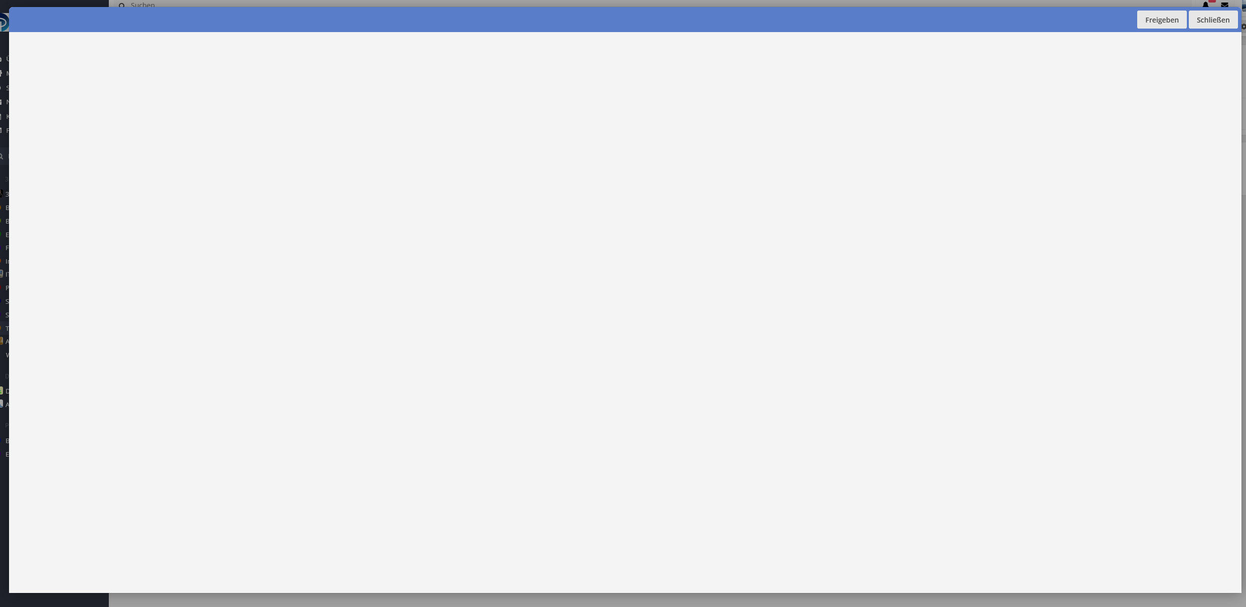

when i try do edit a docx the windows stays blanc

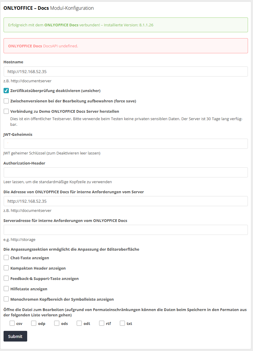

Hello @Abjo
Please go to ONLYOFFICE Docs module configuration, press Submit button and make a screenshot of the page if any error is prompted. Additionally, please specify installation type of Document Server (Docker, DEB/RPM packages, EXE/MSI) and if any changes to Document Server configs were applied earlier.

Please see the documentation:

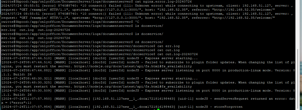

Please check mutual availability between HumHub and Document server with wget\curl commands. For example, go to HumHub server and run wget http://192.168.52.35 (the address from the screenshot). And vice versa, from the Document server run wget http://HumHub_ip_address
After that, please reproduce the situation one more time (click Submit button) and collect Document server logs. For docker, it’s located here: /app/onlyoffice/DocumentServer/logs/documentserver/

with wget i can get the index.html of both server.
the nginx.error.log-20240726 and out.log-20240726 has the following inside

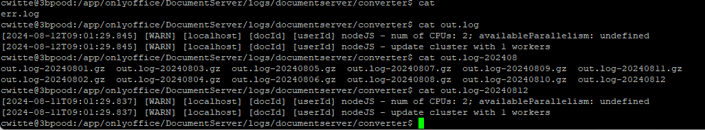

Is it possible to reproduce the issue and provide us with entire Document server logs folder? We would like to take a look at ‘converter’ folder as well.
no issue, here we go

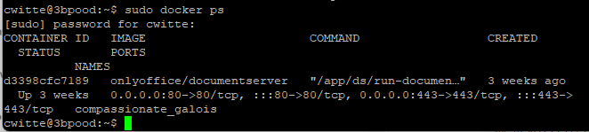

Additionally, please provide output of docker ps command executed from machine with Document Server.
