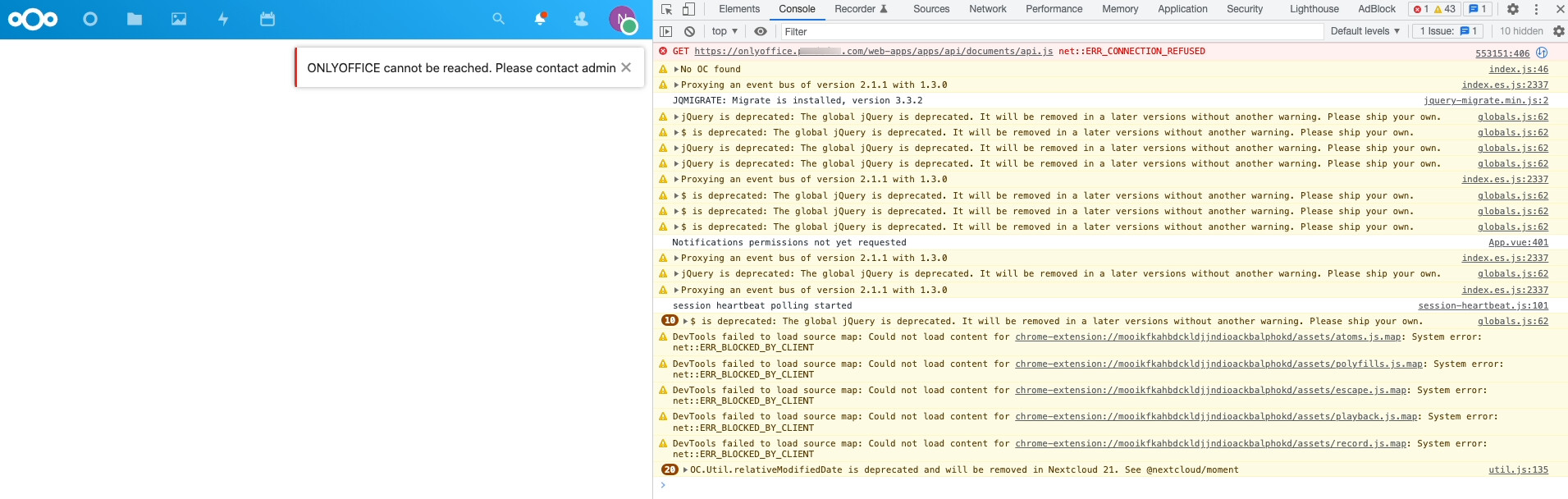

Hello @mamed
Please wait until issue is reproducible and open browser console (F12 in Google Chrome). Please check if there are any error entries in ‘Console’ and ‘Network’ tabs. Please make screenshots.
Is there any proxy\firewall? There’s an error in provided screenshot. Something is blocking api.js. Is the issue reproducible on other PC?

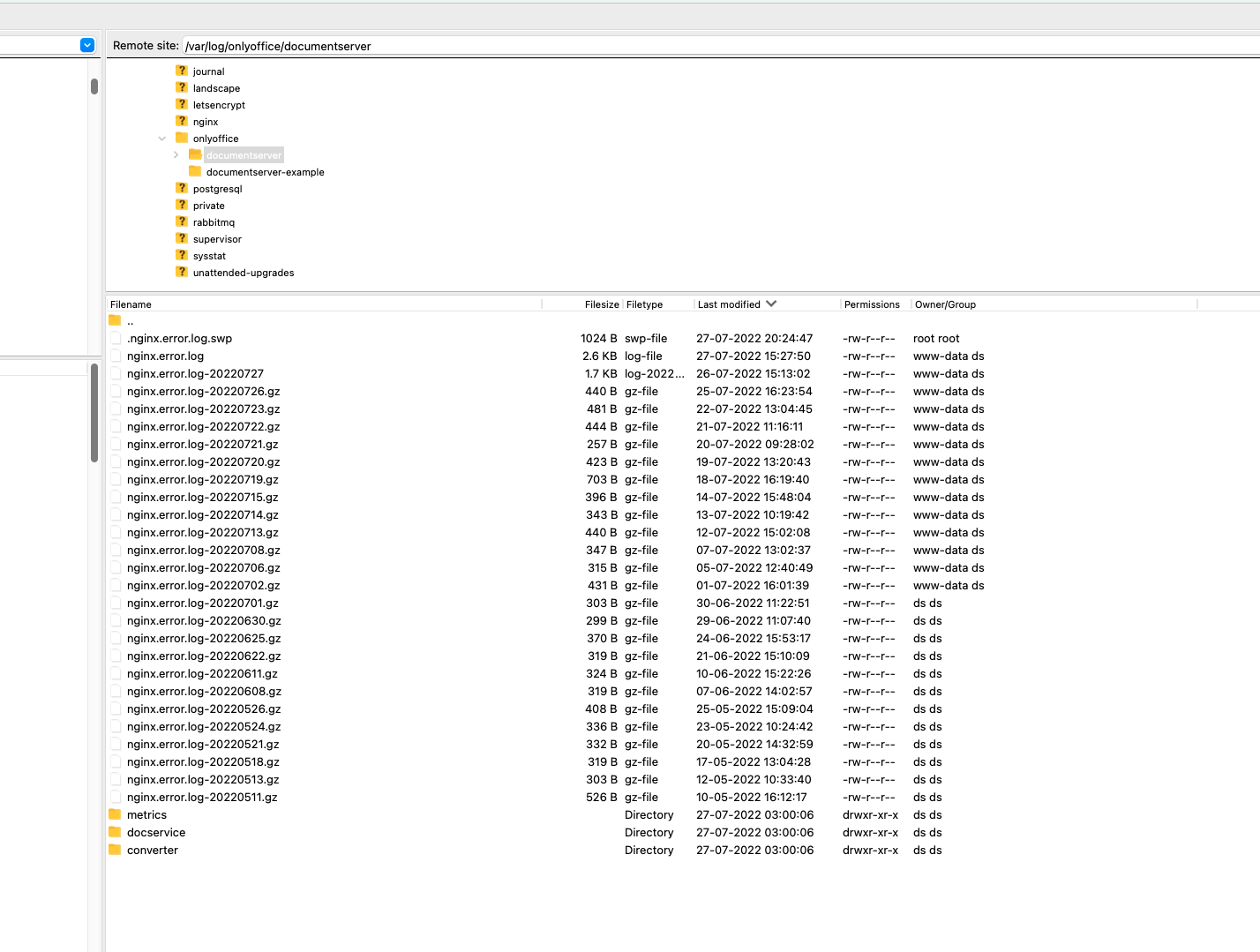

Looks like my Nginx is struggling…
Can I send you the /var/log/onlyoffice/documentserver/ folder (zipped) so you could have a look?
The Nginx error log has a lot of these:
2022/07/27 12:27:50 [crit] 865#865: *171 SSL_write() failed while sending response to client, client: 192.168.4.227, server: , request: “GET /7.1.1-23/sdkjs/common/Images/fonts_thumbnail.png.bin HTTP/1.1”, host: “OO-FQDN”, referrer: “https://OO-FQDN/7.1.1-23/web-apps/apps/spreadsheeteditor/main/index_loader.html?_dc=7.1.1-23&lang=bg&customer=ONLYOFFICE&frameEditorId=iframeEditor&compact=true&parentOrigin=https://NC-FQDN&uitheme=theme-classic-light

Sure, I increased your forum trust level, so you can contact me via PM. Also please check Nginx status when the issue occurs > make a screenshot of the output result.
