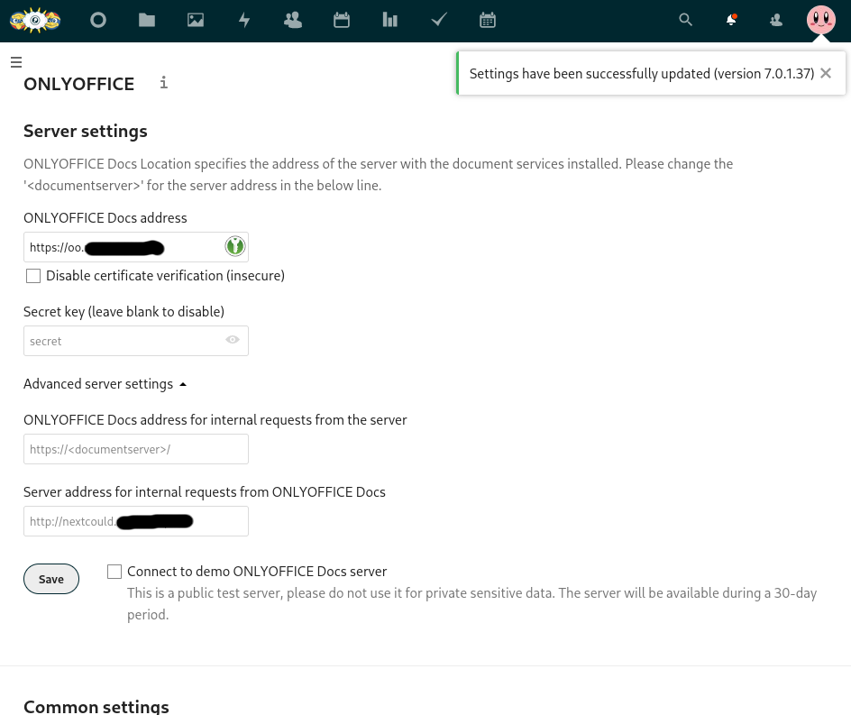

It seems NC ONLYOFFICE Client app is « working » fine as I don’t have any error message when I configure it, I don’t need to set any external specific domain or https as I wan’t OO working within my local network. I access NC from the Internet though, specific certbot wildcards with nginx reverse proxies do what I need for ssl/https subdomains. I did not configure anything yet to make oo open to the outside.
Screenshot of OO NC App :

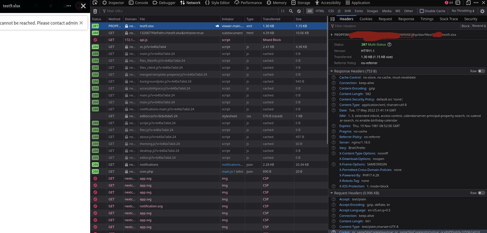

Please try to access the document editor => open the browser Dev Tools (F12 in Chrome/Firefox) => refresh the page and make a screenshot of error messages in Console and Network tab if there are any.
Thanks a lot, I took screenshot of first request as it may contained some interesting infos I guess, others (app.svg & notifications.svg come from other NC apps).
This error from api.js, 172.19.0.5 is my oo container ip, it does same error i use its local network host ip address :
¯\(ツ)
edit : trying to be more specific, typo
Please make a screenshot where I can see the full path to api.js (or copy it here).
If api.js can’t be loaded, the document editor won’t work. Is there any extension that blocks js files in your Firefox? Please try reproducing the issue in any other browser and let me know the result.
http://192.168.XXX.XXX:8018/web-apps/apps/api/documents/api.js

Also here are my nextcloud app settings which does work too, I have no errors here ^^
