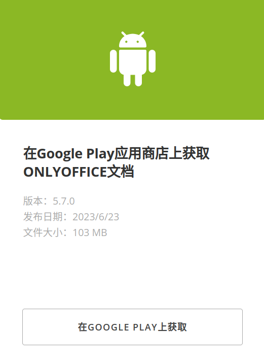

Oh sorry, I downloaded it from the onlyoffice Chinese website and he didn’t update the latest version, I thought it was up to date. Thank you for your help, my error.

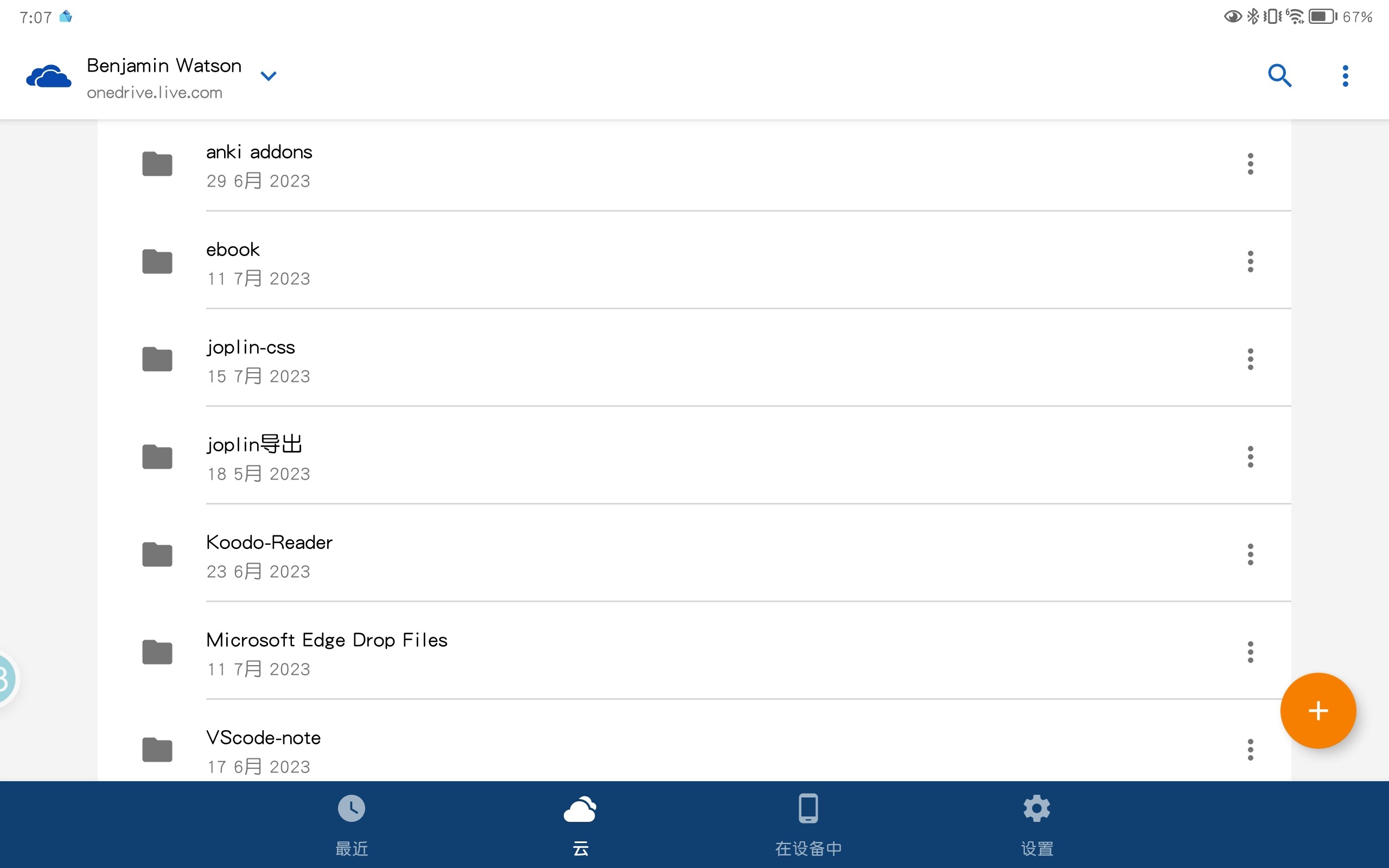

At first he was always white interface nothing responding, this time I waited for a long time, about 10 minutes. He managed to get into the OneDrive file interface and kept loading. I waited patiently for about 5 minutes and finally I was able to load all the files and access them. It’s really slow, and I have no problem with my network. I use other apps to access OneDrive files very quickly.

The device that still has problems with version 5.7 is a Huawei tablet, sorry I didn’t make it clear.
Device name: HUAWEI matepad 11
System: HarmonyOS 3.0
Only on Huawei devices did I find the problem, I tested version 5.7 with my phone (vivo S7 android 10) today and he did not have problems.

Let me explain. This seems to be due to my lack of understanding of different apk files.
You are right, the problem has been solved. Since I installed version 5.7 of the Google Play version on my Huawei tablet, I should go to the onlyoffice Chinese.com to download it.
Previously, the onlyoffice Chinese website was not updated to the latest version, and I mistakenly thought that I was downloading the latest version. With your help, I realized that I should update the app to version 5.7.
However, because Huawei devices cannot install Google Suite. I don’t know where to download the latest apk file. So I went to apkmirror, a famous Google app download site. So the question arises.
Later, the onlyOffice Chinese website updated his version 5.7, and you guys prompted me. However, I thought I had installed version 5.7 of the app from apkmirror, so I didn’t try the 5.7 version of the app for the onlyoffice Chinese website.
In fact they are different after I saw your message today. I thought about it carefully, then downloaded and reinstalled version 5.7 from the onlyoffice Chinese website and the problem was solved.
Thank you very much for your help, I realized the mistake
I realized today that you hosted the android apk file on github. There is no direct way to download the apk file in the onlyoffice website. Can you add his information? Although I already know that it is possible to go to github to download the latest version of the file. But others may not know or make the same mistakes as me.
OnlyOffice is an open source software, and maybe adding its GitHub site is a good idea.
Contribute to ONLYOFFICE/documents-app-android development by creating an account on GitHub.
We are glad that the issue is solved. As for the direct link for .apk file, it persists on Chinese version of website: https://www.onlyoffice.com/zh/download-desktop.aspx#mobile
The link: https://download.onlyoffice.com/install/mobile/android/onlyoffice-documents.apk?_ga=2.123870402.991000486.1691407008-1819572127.1690203478
But you have provided a nice thought, probably we will add this link to all languages on the website.
