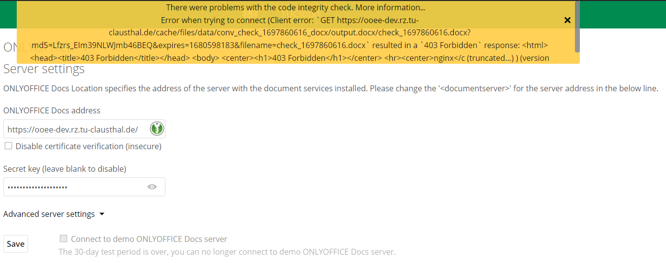

OnlyOffice 7.3 (.3.49) Error 403 Forbidden
I am using Owncloud Enterprise 10.12.0 with the new OO Connector 7.8.1.
OO V 7.1.1.23 (Docker) without JWT works flawless.
I updated the oo docker container to onlyoffice/documentserver-ee:latest
which is version 7.33.49. When i try to save the oo-server settings in the owncloud
connector window the error occurs:
The jwt_header and jwt_secret in the docker-compose.yml are identical to the ones in the
config.php of the Owncloud.
If i comment out the 403 message in the ds-docservice.conf i can save the oo settings.

I had the same error but with Nextcloud, I posted about how I solved it in this thread, perhaps that solution will also help in your case.
Hello @Ingo
Please uncomment these lines, then execute script bash /usr/bin/documentserver-update-securelink.sh and check the situation again.

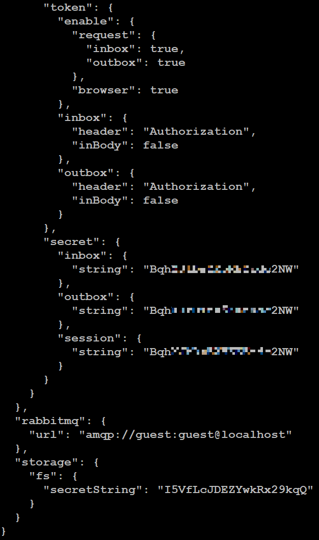

Hello @Ingo
Please check if token credentials are correct in local.json config from /etc/onlyoffice/documentserver/.
Additionally, please share with us your .yml file and log files of Document Server from /var/log/onlyoffice/documentserver/ for analysis. You can send them to me directly via PM.
Hi @Constantine, here are the files you requested:
oc_config_onlyoffice
