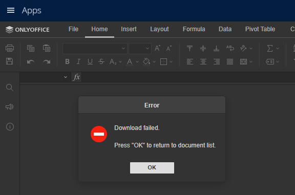

Hi,
sorry just had time to respond again.
yes error in all kinds of files
here is the error in the user interface
![image](https://forum.onlyoffice.com/uploads/default/original/2X/4/48e23144d2451a163274f76521008c0729b25d43.png)
