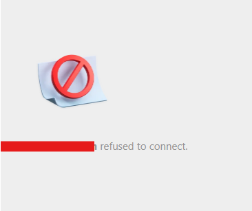

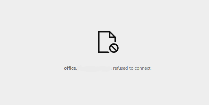

problem: (All Dockerized behind Traefik) When adding a new OnlyOffice document within the Nextcloud instance, the page goes straight into a blank page with a document icon with a stop sign on it. The message states ‘domain.tld’ refused to connect

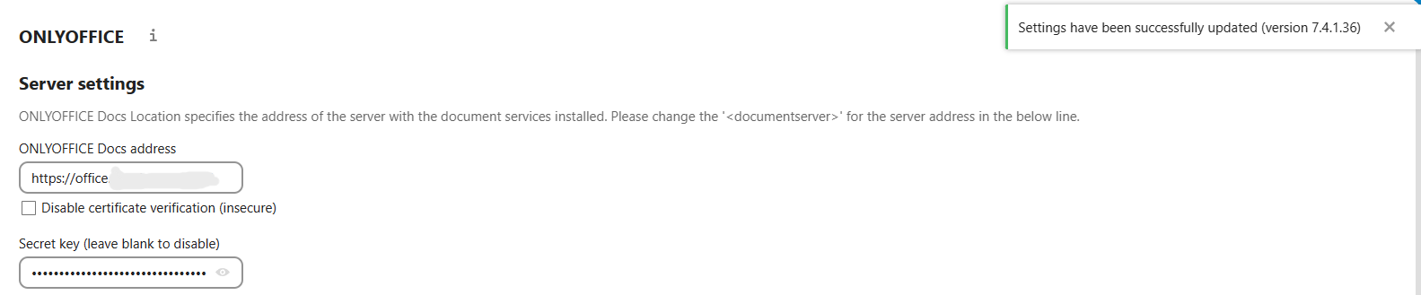

Did you connect your instance of Document Server to Nextcloud via connector app page? Please make screenshot of the settings when pressing the Save button, you will see a pop-up message in top right corner. Also, make screenshot of the page when opening a document for editing via Nextcloud.

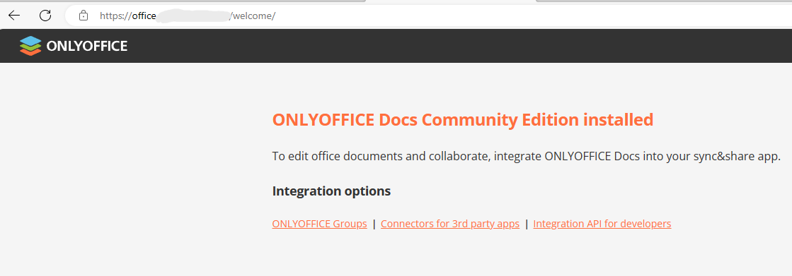

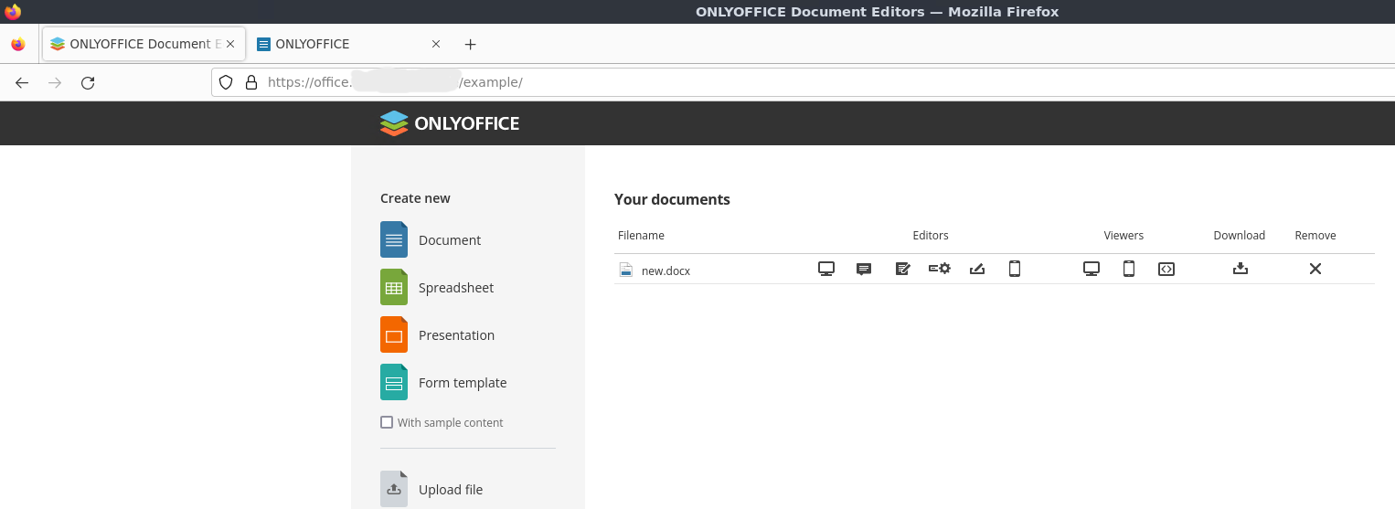

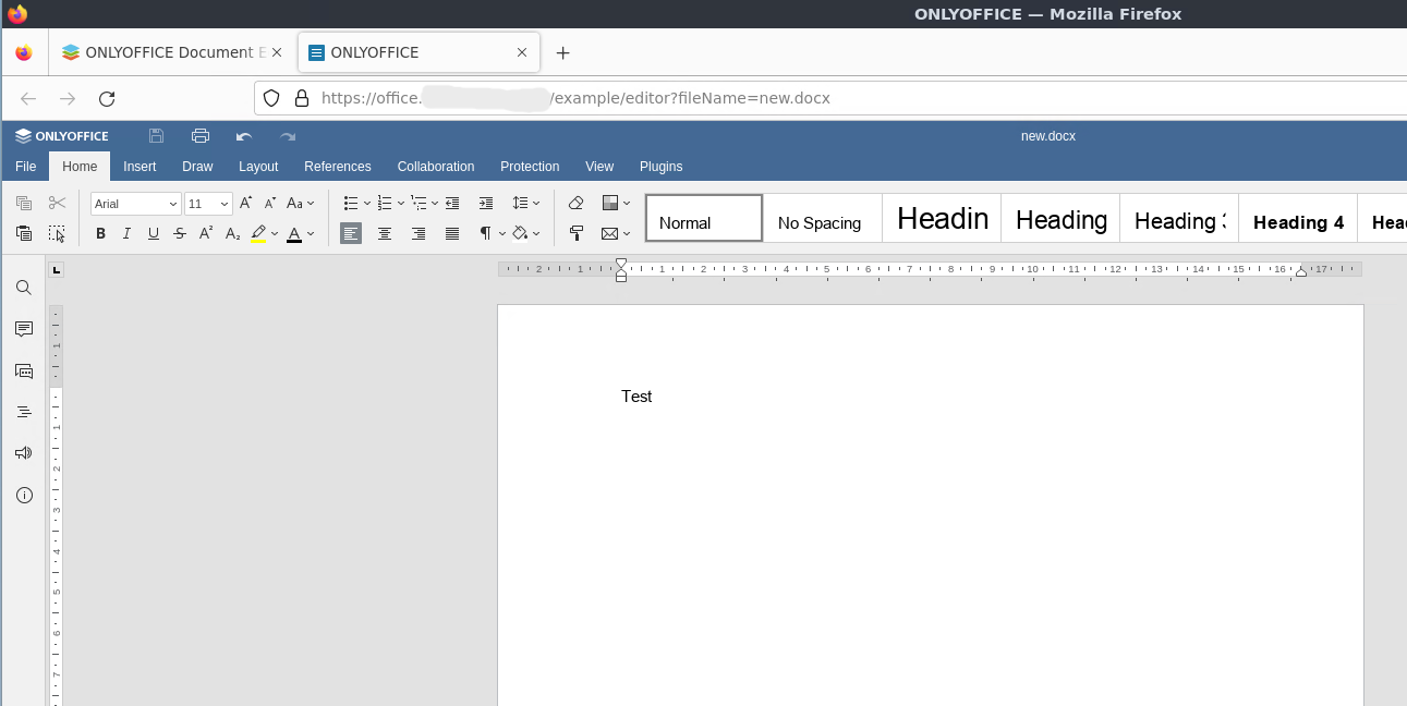

In the meantime, please check editing in integrated test example to make sure that Document Server works properly. To do it, navigate to the Document Server address in browser, on Welcome Page you will find instruction on how to enable integrated test example. Once it is enabled, press GO TO TEST EXAMPLE button and try creating/uploading a document to edit it from there. Let me know the result.

Yes I did, I used the connector app page.

I was also having this issue. I seemed to have fixed it by mapping a conf file to the document server container containing the following line"
add_header Content-Security-Policy “frame-ancestors self your.nexcloudurl.com;”;
The file name need to start with “ds-”, for example “ds-fixme.conf” should work. I mapped this file to /etc/nginx/includes/ds-fixme.conf as read only in my document server container.

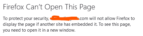

I know the problem has to do with iframes, and my Nextcloud instance embeds the onlyoffice session in an iframe. There may be something in a Nextcloud config file somewhere to prevent this, but I’m far from being an expert in this field. It seems like in older versions of the community document server this wasn’t an issue, but what I can’t remember is if Nextcloud always used an iframe or not.
One followup to my workaround is that I noticed when using Nextcloud via a local IP address I still got the same error until I added the local ip of my Nextcloud server to the add_header line. So now it looks like this:
add_header Content-Security-Policy “frame-ancestors self your.nexcloudurl.com 192.168.x.x;”;
Now it works when accessing using my domain name from outside my network, and when accessing nextcloud using a local IP.
I also found that using a Chrome extension called Ignore X-Frame headers allowed Onlyoffice to work in Nextcloud. That’s how I narrowed it down to an iframe issue; but now everything is working with that extension removed.

I wasn’t seeing any errors from Nextcloud that led me to the root cause of my issue. Nextcloud was embedding Onlyoffice into an iframe, and nginx in the docserver container was not allowing this. Not sure Nextcloud was aware that something was wrong (although I could have missed something). When I used firefox, it actually gave me a more specific error.
This led me to assume the Nextcloud config wasn’t my issue (not saying that this can’t be fixed in Nextcloud), but the webserver in the docserver container was. I went down a rabbit hole of nginx configs on various forums to allow embedding and came across that line that posted above that finally worked.
I am a mechanical engineer, so my understanding of how all this stuff works is very minimal and it is just a hobby/learning experience for me and I’m just stumbling through it; just figured I’d share my experience that got me up and running.

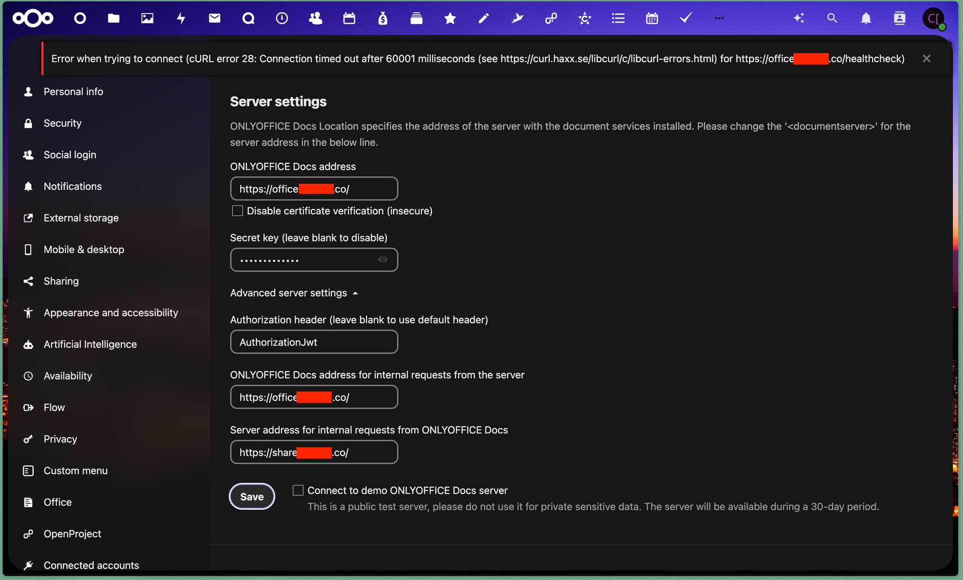

Hi, I am having problems with one of my Nextcloud servers unable to connect with my OnlyOffice document server using the Nextcloud Connector 9.4.0. While couple of my other Nextcloud servers are able to connect to my common document server, this one throws an error when I click on the SAVE button and does not showing common settings section and the rest of the settings.
Can anyone help please?
I also tried what was suggested in the following link as well:
