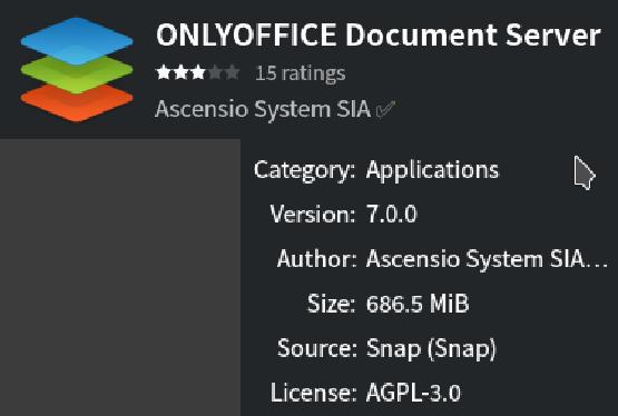

Have you installed the Document Server on a desktop PC? Could you attach a screenshot with the name of the product you installed?
It’s installed on my desktop PC from the Kubuntu Software Center:
onlyoffice

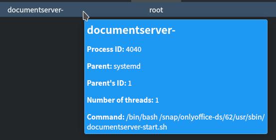

and it is running as can be seen in the System Monitor
onlyrunning
In this case you need to somehow expose your PC to the internet so it has an IP address that is accessible from your Nextcloud. Right now your Document Server should be available at http://localhost, but you won’t be able to indicate localhost as the Docs address in the connector settings.
