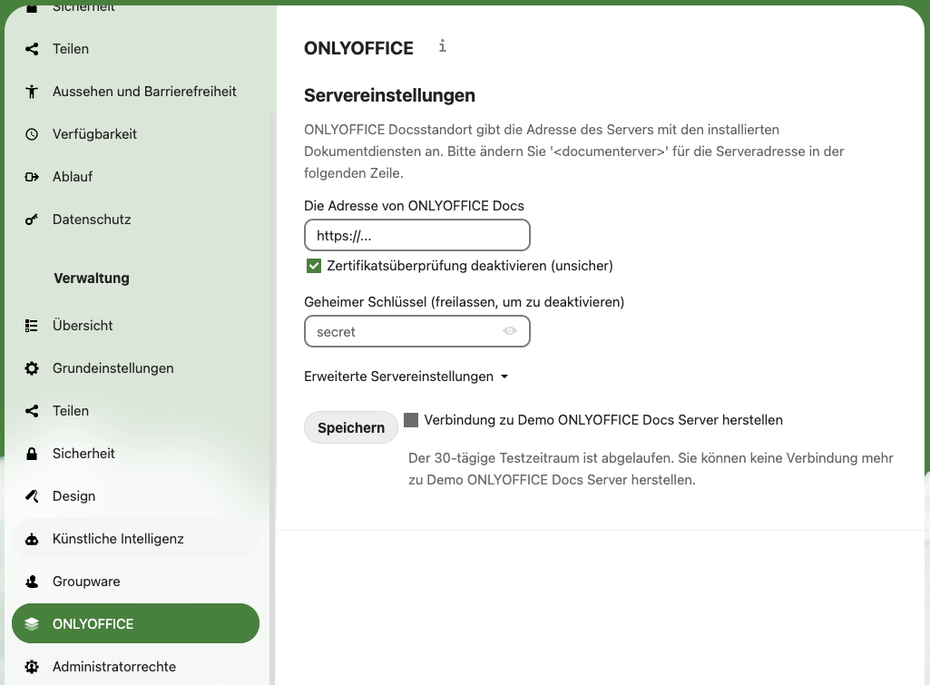

We have had exactly the same problems since the update to 9.2.0.
Managed Nextcloud at Hetzner (StorageShare)
The problem is that the save button is inactive and you cannot save the entries in the app configuration in the Nextlod app.
The save button is without function, so we cannot edit and save the address of ONLYOFFICE Docs.
NextCloud Version: 28.0.3
OnlyOffice Version: 9.2.0
Hello @Florian
Thank you for the provided data!

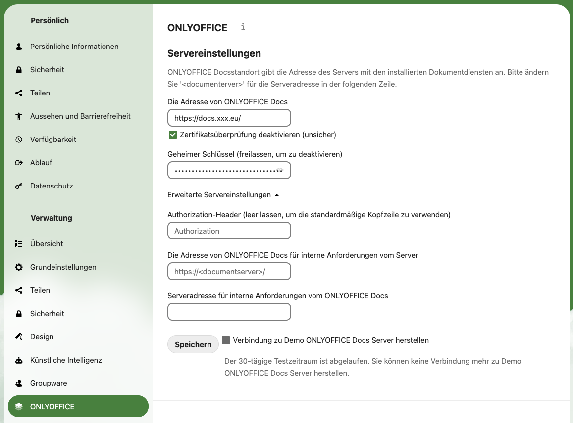

Could you please make screenshots of entire connector page? We need to take a look at your connector settings.
Hello @Alexandre
Thank you for your enquiry.
I have already posted a screenshot of the Konnector settings, here is another screenshot of all the settings for this point.
However, the problem is more likely to be that we cannot save the settings. The save button has no function. Various JavaScript errors are displayed on the page as already mentioned before.
I have made the address of ONLYOFFICE Docs unrecognisable for the screenshot, as I can’t save it anyway.
We use StorageShare with Nextcloud 28.0.3 from Hetzner and the “ONLYOFFICE Docs Community Edition 9.2.0.” on a cloud server at Hetzner.

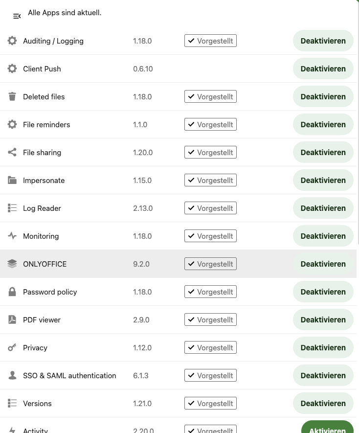

Thank you for quick reply. Could you please show us the list of installed apps (plugins) on the Nextcloud side?
Also, please disable > remove > re-install our connector app. Will the situation reproduce again?
We have already reinstalled the OnlyOffice app several times without success.
