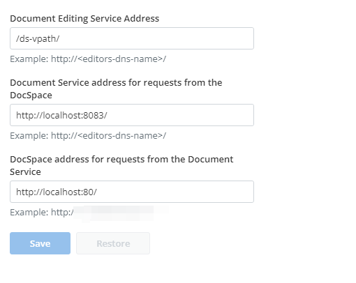

I have succesesfully setup the latest docker docspace on ubutu22 and configured email integration.
I have my admin user setup.
MY CONTAINERS LOOK LIKE
MY INTEGRATION FOR DOCUMENT SERVER LOOKS LIKE (vanilla)
When I try to open a supplied sample doc I see
What settings do I need in the document integration page?
thanks
Ivan

With my docker deployment above, what settings do I need?
thanks

Really need some help to get this deployment finished.
Does anyone have screen shots of there docservice integration page they can share with me?
(obfuscated) showing DNS names and IP adresses in a docker deployment of Docspace
Thanks
Hello @ivan
Your integration settings seem unusual. The portal uses forscotland.com domain name, meanwhile you have specified DocSpace address as docspace.forscotland.com .
Here’re my settings from a test server, please try to use them or just click ‘Restore’ button:

thanks Alexandre. I’ll give it a try. Appreciate you all work so many support questions. I’ll give feedback. The key thing is you expect TCP listeners at ports 80 and 8083.

Hi Alexandre.
I am running HTTPS with my own certs, Immediately after docker install I ran.
bash /app/onlyoffice/config/docspace-ssl-setup -f forscotland.com /etc/ssl/meet.forscotland.com.crt /etc/ssl/meet.forscotland.com.key
There is no listener on port 8083
My docker ps -a looks like
I did see this warning at the start iof the docker install
thanks
Ivan
