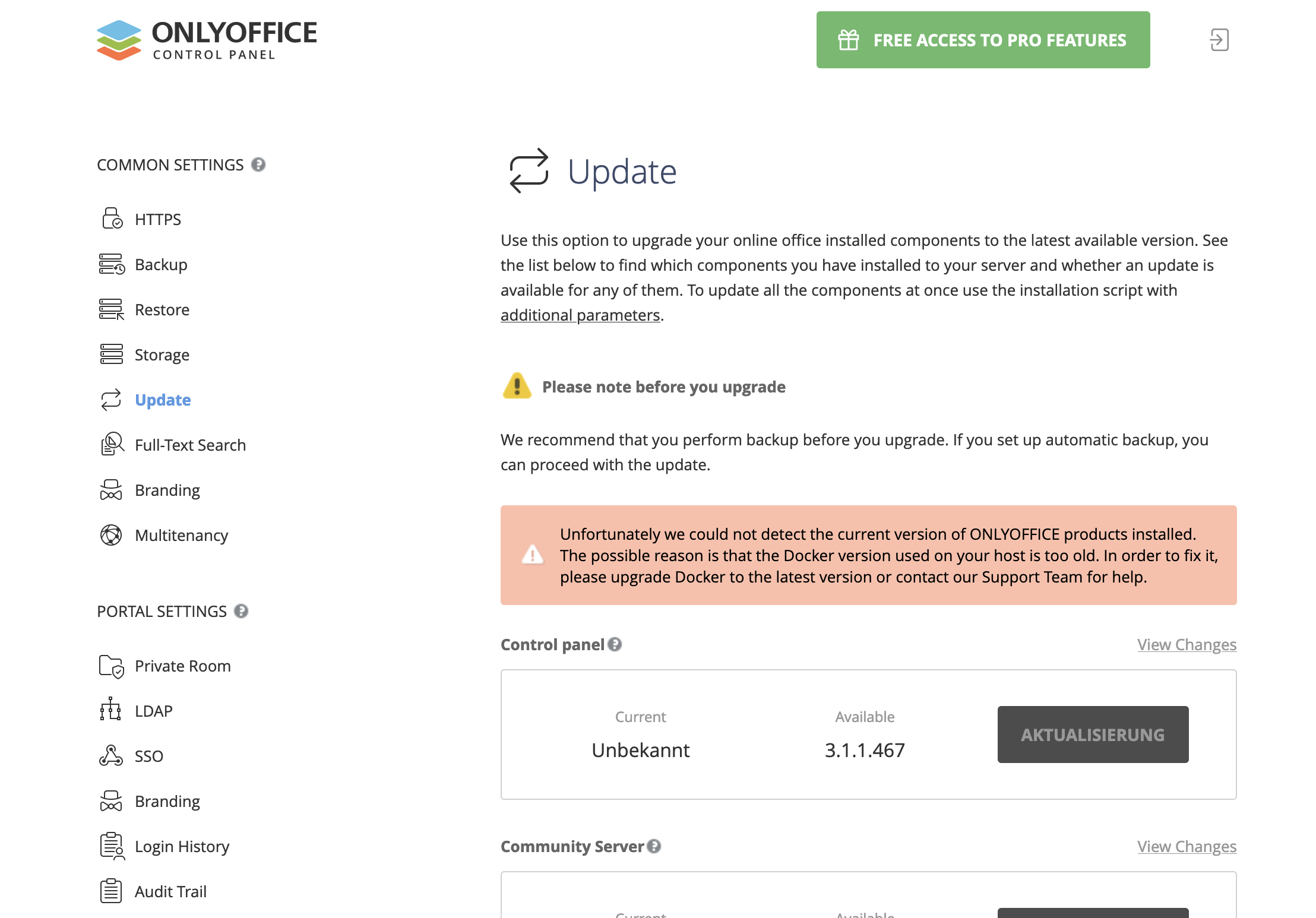

P.S. I remember that Control Panel > Update gave that it’s not possible to find out the actual versions and that in might hang with the docker version, but the docker version was the latest.

And the control panel update looks the same as before:
Docker version is 20.10.21

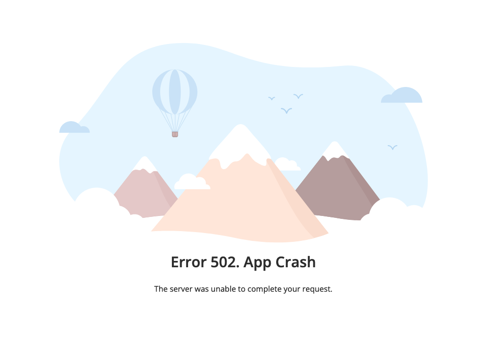

I still quite offen get :
And the load explodes from time to time (close to 300% CPU usage on docker stats for mail and community server).
But thank God and all the IT giants, docker handles the revival and it’s usable for our small team.
