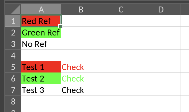

Hello @ewok2
I’ve changed the comparison block a little and now it returns following result:

Second for block was removed. Some reference points were adjusted to follow the logic - getting fill color from column A, adding “Check” word to adjacent cell in column B, applying the same color from fill to inserted word.
Not sure if this is the goal according to your description, but feel free to correct me by providing more details on the desired result.
